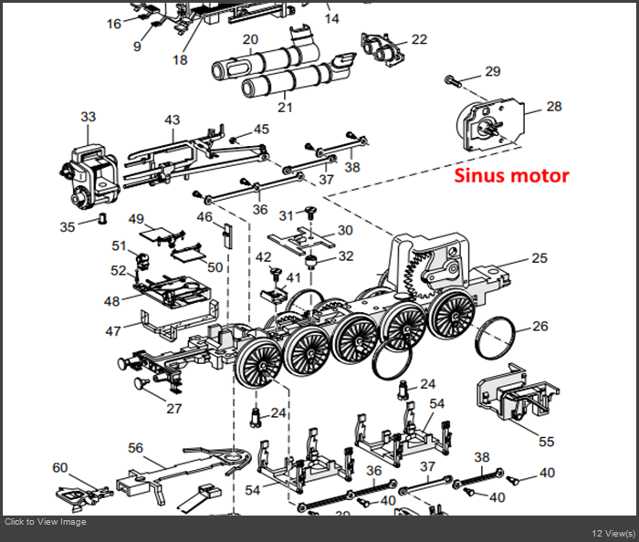

I have the insider model grey Franco-Crosti 39160 BR 42 with C-sine motor and it appears the decoder was fried. Some years ago I sent a a query to Marklin about fixing it but never followed through. What is the simplest way to replace the decoder with a newer one, are there decoders that would be simple/complex enough to use in replacement?

This loco was released in 2000-2001 with a Sinus motor (Full size early model) not a Compact Sinus (C-Sinus), not a Softdrive Sinus (SDS)
Here is the motor and loco part
Here is the electronics in tender
So from what I see (I may be wrong, it must be checked) the electronics is all in one piece and if EITHER the motor is bad OR the ELECTRONICS is bad, then no simple repair can be made. No repair from Märklin to be expected.
There is a company in Switzerland providing replacement drive electronics
There is a company in Germany to replace Sinus motors with DC ones (then a mSD3 will do to drive it
Sadly I don't remember their names. Maybe someone can help?

For the old sine motors in wich the electronic of the motor and decoder are inetgrated in the same PCB for repairing and/or upgrading to newer sound (or not) decoders, you can get the electronic board with Mr Erich Iten in switzerland at www.rail4you.ch
Of course you will also need a suitable decoder also. For this particular loco wich has not a flex strip to connect the motor to the board but cables, you will also need an adapter wich is also provided by Mr Iten.
I have used them in several locos to upgrade to better sound decoders, and the work great.
