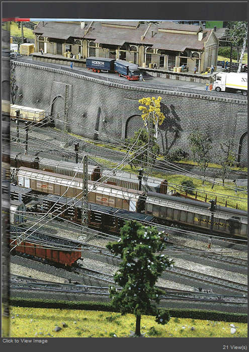

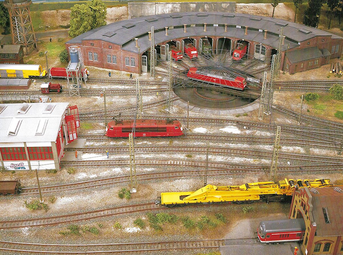

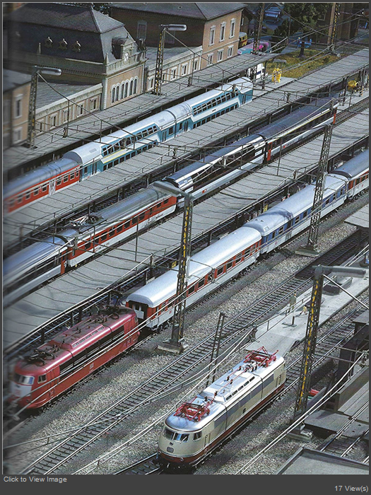

In recent years Marklin have been advocating (via their books) the ultimate layout would be a hybrid of C and K track. Here is one such book and I enclose some photos showing their ideas, in some cases the C track is painted and ballasted and laid on top of the scenery in first few photos, but elsewhere in the book they show the C track connected to K track and cut inot the scenery and ballasted and painted to match the K track, and in some photos its hard to tell which is which, and clearly a lot of time (and money) has been spent to match. Merkur who make the ballasted trackbed for K track also used to make loose ballast to match for such occasions.

I hope these give you some inspiration and ideas
