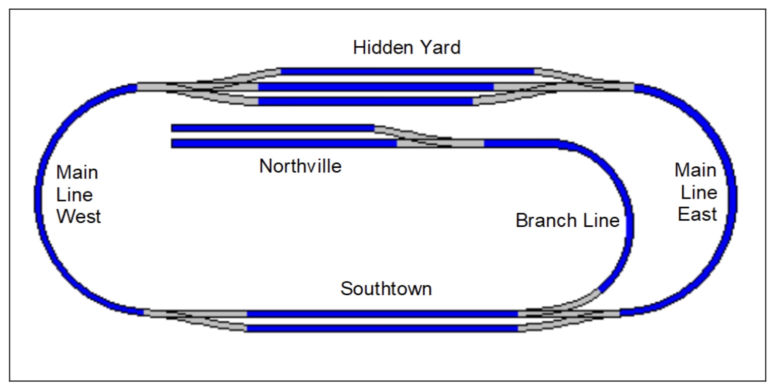

1. A block is a certain length of a track between turnouts, that could fit your (longest) trains (see principle in the drawing below). If you have a long line between your turnouts, you could define several blocks on the line. iTrain will NOT automatically see the presence of trains within your blocks.
2. You need at least one sensor per block. Two sensors - one track piece at each end of the block - are better as then they could notify iTrain to initiate trains to BRAKE and STOP, in each direction. Adding a third sensor, for the track between the initial two sensors, is even better in order to provide OCCUPATED notification to iTrain.
