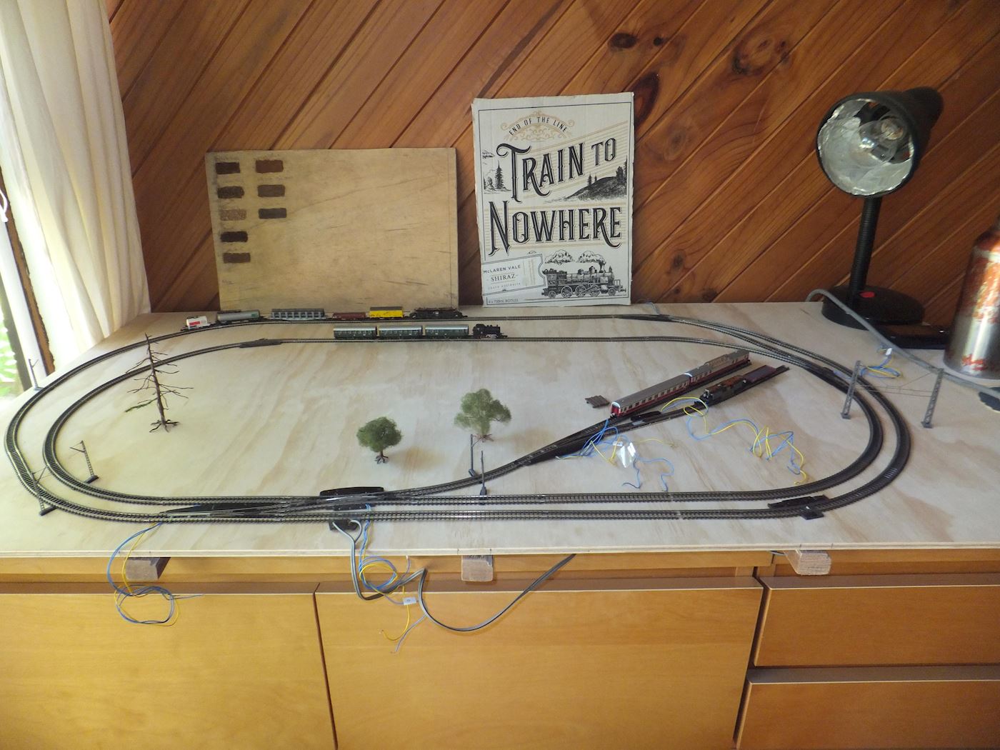

I had a starter set with the addition of a diesel locomotive and extra pieces of track, a turnout and a signal.
This was in storage for ~30 years until Covid came along and we had time to clean up the house and re-discovered said pieces.
I watched many Youtube videos, and wanted to jump right in.
I did all the newbie mistakes mentioned.
I was so eager to start, I bought a lot of stuff, and started to build a 1200 x 600mm layout.
But that size layout would only allow a double loop and a few spurs. I got dissapointed in the realisation that if it were to be finished it would be very boring to operate.
I also have very little modelling experience and had a long hard think about it.
I came to the conclusion that I won't be building a layout as:
a) I only have 1200 x 600mm available space
b) I need more experience in modelling

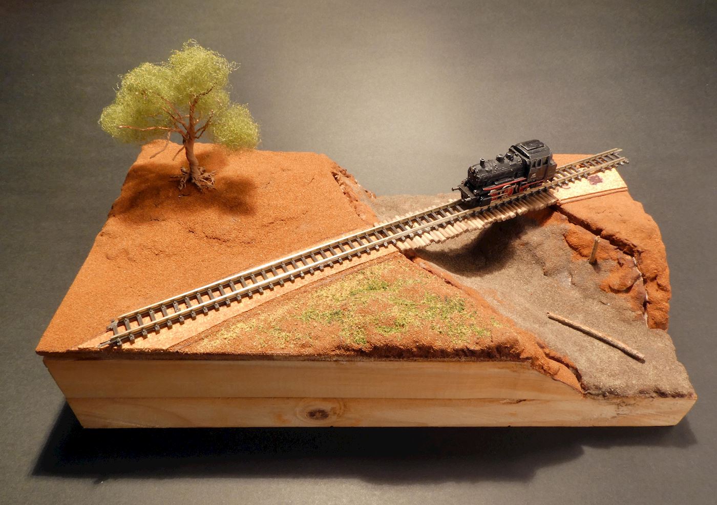

  • a beginner should buy some items to experiment with and don't even think about a layout
  • a beginner does not know how much time it takes to model, and needs to factor in how much spare time they actually have
  • the beginner should construct lots of micro-sized dioramas, with each one building up the complexity and size
  • the dioramas should eventually be "working" dioramas in that there is power to the rails and anything else, eg: street lighting, buildings
This approach would have the diorama sized as a do-able unit of work, which is not too daunting, and ultimately resulting in satisfaction, not dissapointment.
Much like hxmiesa's recommendation ThumpUp
My first diorama that has taken a month from design to construction up until this stage

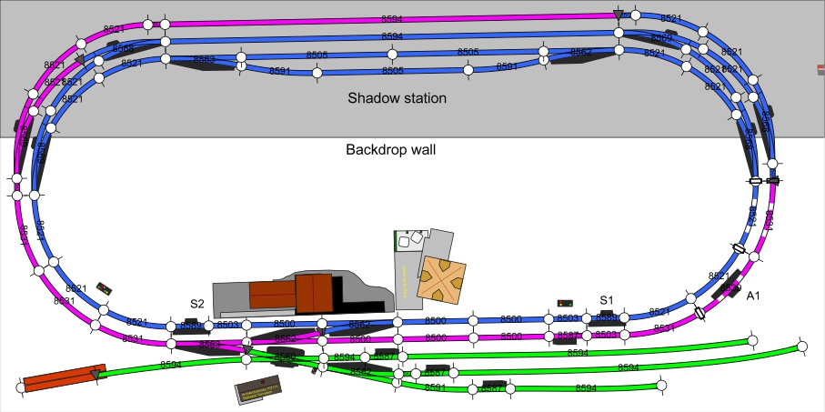

With only very limited space available, a "good" layout can still be made;
(Taking notice of your 1,2m x 0,6m space)
Make a simple oval. It´s not even necessary with a multi-level layout.
Build a "wall" cutting off around 1/2 of the space (1,2m x 0,3m). Use tunnel portals to let the oval mainline enter and exit this hidden space.
Cram A LOT of sidings into the hidden space.
In general, think of the layout as a THEATER;
The front/visible part is where the action takes place.
Behind the stage is where all the "actors" stand ready to do their part on-stage, when the moment come.
That way you can easily have a small(ish) rural station in the visible part, where only shorter trains stops. -While longer express/freight trains just pass through, before waiting again in their hidden siding.
This is a well-known concept called a "shadow-station".
(Some british people might call it a "fiddle-yard", but I would argue that there is a subtle difference in how it is operated and controlled!)

That's an excellent idea.
I'll see how many sidings I could fit and the maximum train length I could run.
Turnouts take up a lot of space, so I might have to use the Märklin miniclub (Z scale) curved turnouts (though some people recommend to avoid these)
Here is quick mock-up of what could be achieved:

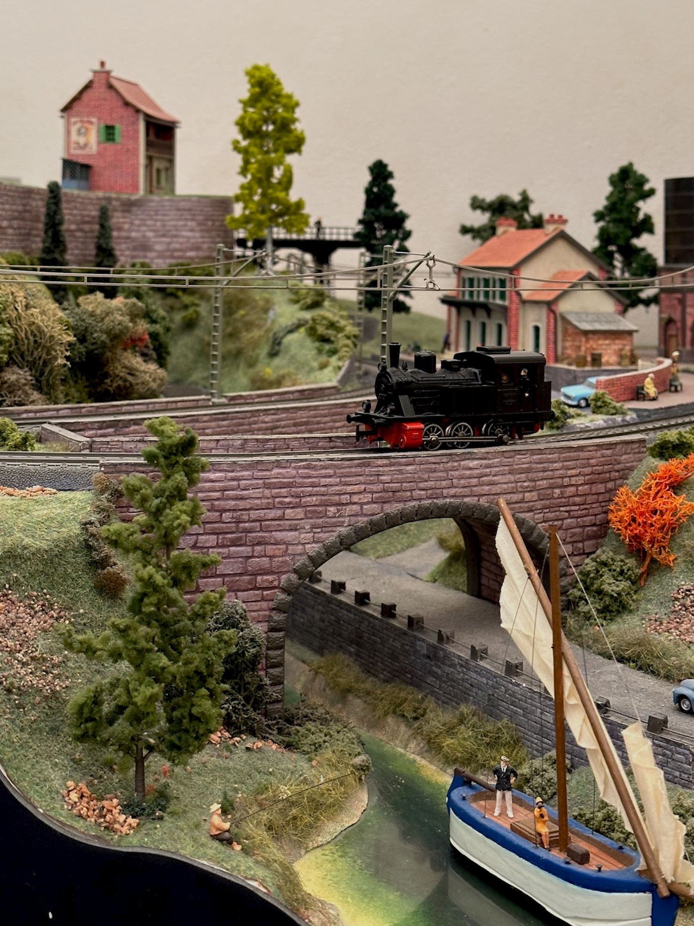

Hi !
For the riverbed below the track level,
I have placed all the tracks on plywood upon about 5 inches high wood piles.
This way I could add bridges and water upon easily even if all tracks are flat.
And I kept this idea when I built my layout.
The landscape is made with foam board, kind of a cardboard sandwich with foam inside...
I made it and modified it directly on the layout.
And something else, remember to provide space for catenaries under bridges and tunnels.
I hadn't done it at the start, and I later regretted it when I purchased my first electric locomotive.
And congratulations on your project !

I wouldn't start out with any "hidden" parts. Not that it isn't a great solution, so I'm not criticising the idea. But as a beginner anything can and will go wrong (usually not in a disastrous way of course) so it's nice to have everything on the layout in plain view. You can always add some scenery to spice up things.
