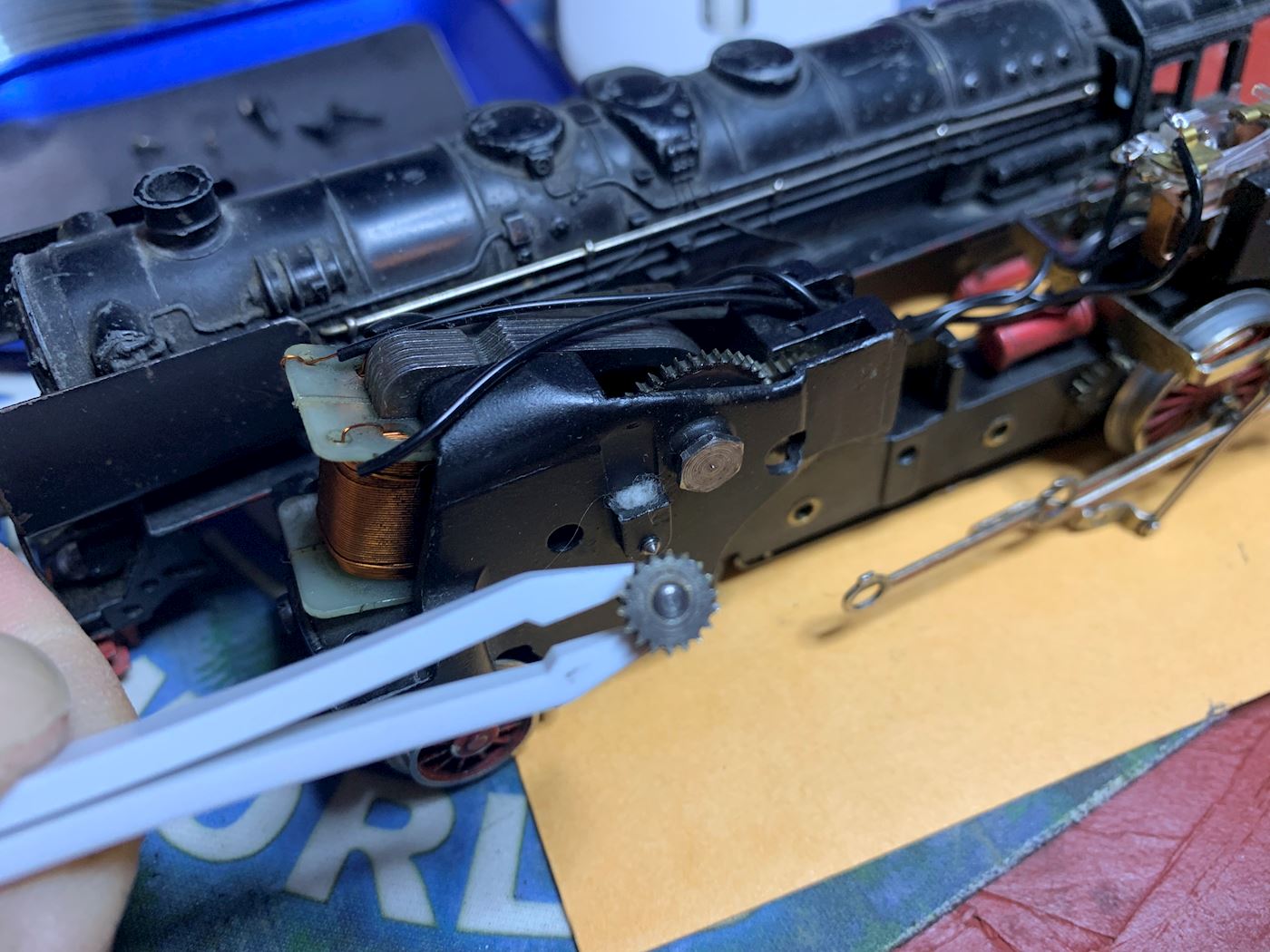

Where might I find a replacement idler dear for this F800? Is there a part number? It’s 18tooth /2.5mm shaft. Thanks in advance. IMG_2065.jpegIMG_2064.jpegIMG_2075.jpeg

It's beautiful and I'm sure you'll find a gear. A machinist with a lathe can make one.

The idler gear is the same for the 3031/3032
regards Per

I believe you may find it there under the part number 00.452.8.0 (near the bottom of F800 parts page.
https://ttn-shop.com/ersatzteilliste_f800.php
Check the dimensions before ordering

Thank you. I found a set on eBay searching that part number. They don’t appear to have a snap ring groove on the shaft, but I’ll just use my old shafts if need be.

I suspect you may need a full set of gears. From my memories of my Dad servicing these when I was young the gear teeth get very worn on all the gears. Replacing just one gear may not sort out whatever problems you have that is ccausing you to want to replace this one.

I agree with Alan, take a detailed look at all the gears, if one is worn out many of the others won’t be far behind. And putting a new gear in mesh with old worn gears will accelerate further wear.
I have found with the old locos of that vintage, replacing all the gears, the armature, and the driving wheels results in a beautiful running loco.
If you are struggling to find gears, try Ritter restorations.
