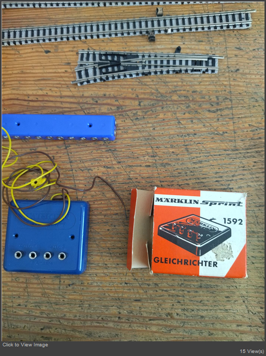

5.On one of the pictures there is a long blue terminal with + and -.
I don't now for what is it and how to use it and how to connect it.
6.On other picture is Marklin Rectifier little blue box with brown and yellow wires
Again don't know what is it and how to use it how to connect it.

The two transformers are AC, so that will not work..... but you have also the "1592 gleichrichter" that changes the AC from the transformer to DC that the lok needs.
Connect the brown wire of the square blue box to the brown terminal on the transformer, the yellow wire to the red terminal. One connection of auto 1 (on blue box) should go to one side of the rail, the other connection of auto 1 to the other side. On the long straight track with the connectors on the side.

Yes, that will work direct,
BTW, the long blue strip wit + and - is only a connection box to connect multiple accessories to one power supply
