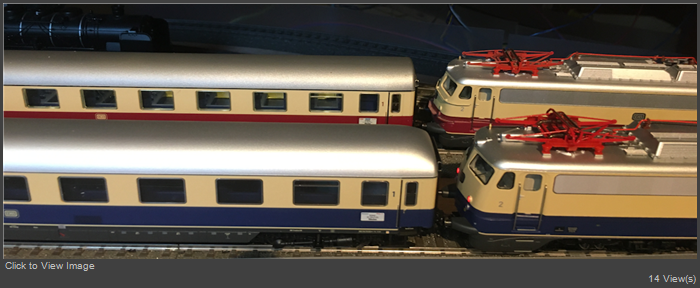

It is great to have you with us in this great forum. Here a Märklin fan from France.
Here are the two trains side by side in one of my shadow stations. Sorry for the part view of trains due to support pillars
First the locos and compartment cars
Then the dome cars
Last, the kitchen restaurant cars
Sorry, the high capacity cars are missing
Also in 2007, Märklin produced a blue Rheingold but not as a set 39121, 43850, 43860, 43870, 43880 (the key difference between both 2012 models was no horizontal railing on the blue locos) Not sure here, since I don't have the 2012 blue set.
To answer your question: I like both sets pictured above and:
- the 2012 set has fantastic running characteristics (SDS motor) but a very simplistic decoder with a toy-like horn and no dome car lighting possibility (pictured is home-made lighting.
- the 2022 set has a much better decoder (many more fonctions including motorized pantographs but some toy-like sound and pantograph cannot sink completely). The restaurant car decoder is sophisticated including a fire simulation in the kitchen compartment with an orange blinking light and the chef yelling oil fire!
