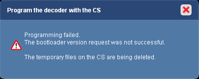

I am following the instructions of the mDecoderTool3 (version 3.6.0) and when I try to program the locomotive with the CS (I am not using a Decode programmer) I get the following error message:

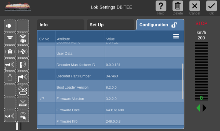

I checked the firmware and bootloader versions and I got the following information:

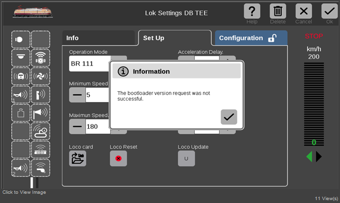

Doing some research I learned these are not the latest version of the firmware and boo loader. With that in mind, I tried to use the option "Loco update", and I received the following error message:
Apparently I cannot update the firmware and bootloader of my decoder. I tried the same process with a few different locos (with retrofit decoder, with and without sound) and I always received the same message. Needless to say, I had the CS3 connected to the internet via Ethernet. Also, I am running my CS3 with the 2.4.1.0 update.

No I cannot check the firmware of other locos on the Set Up page. I always get the same error message “The bootloader version request was not successful”. The problem occurs with old locos with retrofit decoders (I tried a few) as well as new digital locos (I only tried with one). I can only check the firmware info on the Configuration page.

the error message you receive, is an indication that you are using the main track output and not the programming track.
