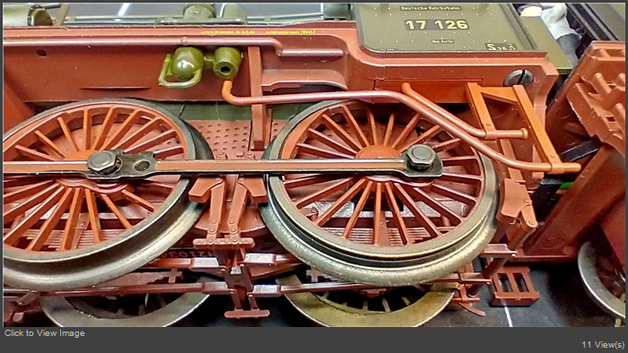

Hello All,
I have a BR17 (Marklin #37192) fitted with the original DCM motor and LokSound 5 decoder. This is a very nice loco; it's heavy and runs very well on level tracks. However, even when new, this loco was unable to negotiate even small grades (< 1%). I fitted a LokSound 5 decoder thinking that I could adjust some parameters, but no go! Runs great on level track, but can't pull any cars.
Is there any hope? Rubber tires were changed to no avail. Perhaps the groves in the wheels are too deep and the rubber tires can't get enough grip...
I'm at a loss. Any help would be much appreciated. It's too nice a loco to sit on a shelf.
Thanks!
Andry

This is a notoriously weak design as to pulling power. The original Lok pulling the Kaiser Wilhelm train, could hardly pull the consist on level track.
I would open it up and add some weight over the driving wheels if possible.

Hi Andry/All,
I have the 2681 King Wilhelm set and had the same poor pulling problems that you are having. See my article below pages 16 and 17

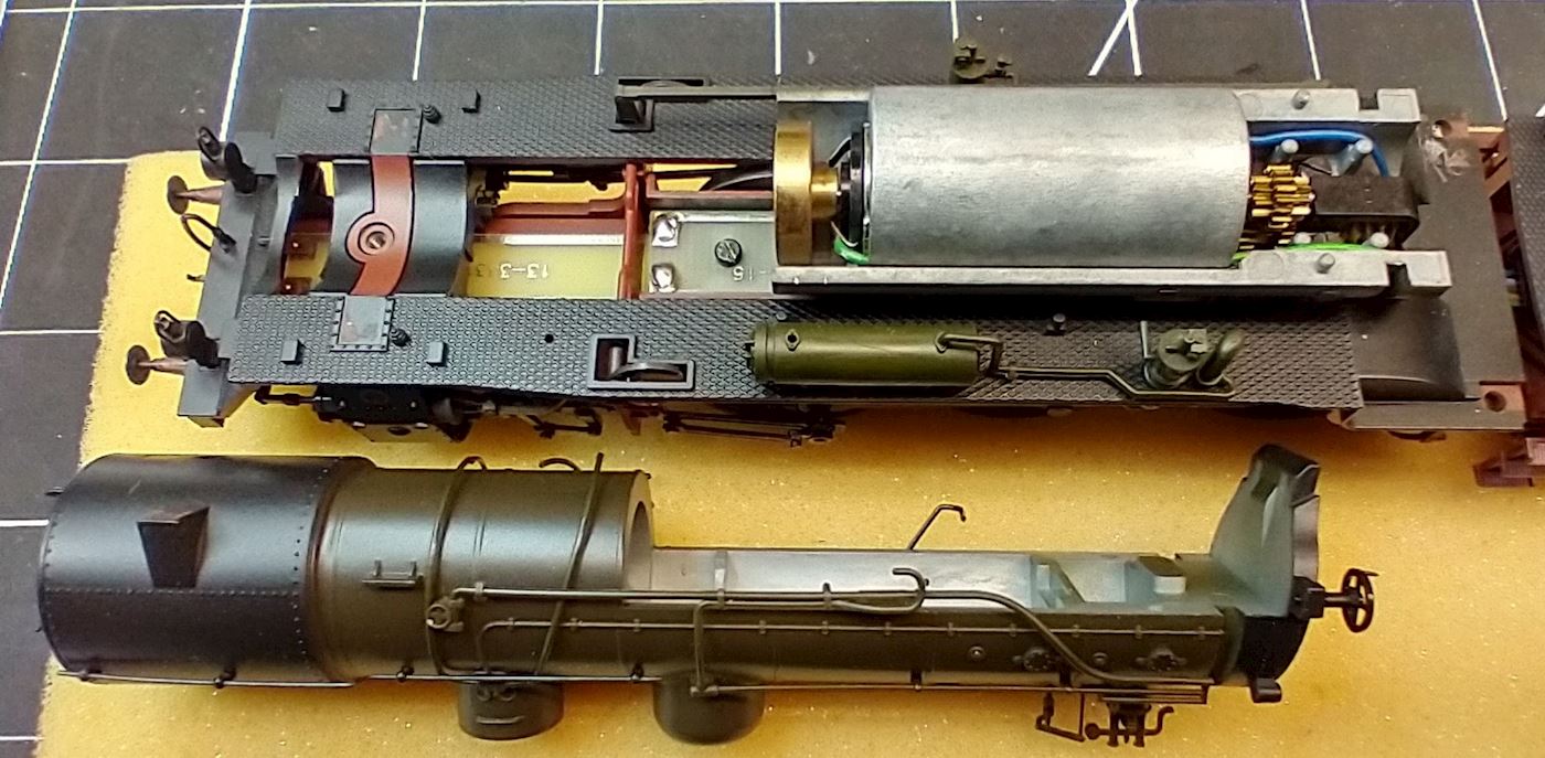

is this an actual photo of your loco, it would help if you can take a photo from underneath
Hello John,
Attached are a few photos of my BR17. The one posted earlier was just a generic picture to help people visualize while reading my post.

Hi Andry
Just a shoot in the dark but by increasing the pressure on the front bogie will add pressure on rear axle with rubber tires

... by increasing the pressure on the front bogie will add pressure on rear axle with rubber tires
Hello Jean,
Thank you for the tip. I've added lead weights to a few locos -- attached to top of boiler with two-side tape. I'll have to see if there's room over the front bogies in the BR17...
Thanks,
Andry
Andry
// Marklin HO K track; ECoS; TrainController Gold; Marklin & ESU decoders; Arduino controlled Switches, Semaphores & Accessories (DCC); Win 11 //
#11 Posted : 30 March 2023 17:48:39(UTC)
Posts: 15,488
Adding weight over the front bogie will reduce the pressure on the axle with traction tyres.
Increasing the tension of the bogie spring may help.
IIRC locos returned to Märklin received some ballast weights in the cab. Maybe you can hide some weight in the cab, e.g. under the roof.
#12 Posted : 30 March 2023 21:51:22(UTC)
Posts: 3,619
Thank you for the tip.I've added lead weights to a few locos -- attached to top of boiler with two-side tape.I'll have to see if there's room over the front bogies in the BR17...
It was not about adding weight to the front of the loco but by increasing the stiffness of the spring on the front bogie, it will push some more weight to the rear axle.
In that same direction make sure there is a little vertical play between the tender and the loco.
Hello Tom,
Thanks for the info. I did some digging and found very helpful tips on Ross Stewart's web site regarding adding weights: "Tip:Strange Happenings Log" (http://members.ozemail.com.au/~rossstew/rms/marklin.html). I was able to decipher how to take the cab and boiler apart. I noticed that the cab roof already had the Marklin weight insert (see pictures). However, because there's more room under that roof, I was able to fit additional weights. I also took the opportunity to add a small weight inside the boiler (see picture). This is all due to the excellent write-up by Ross.
I will now have to put the loco on the track and see if this helps. I would still like to explore the traction tire options...
Hello Jean,
Yes. I will bend the metal spring under the front wheels and try and force additional pressure on the rear of the loco. The coupler between the loco and tender does have vertical play, so that should help.

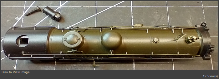

Hello All,
Success!! BigGrin
Just ran some tests with the modified BR17 and everything looks promising. The loco nicely pulls some cars up grades and has no issues. Summing up, the mods I made were as follows:
1) added weights to the roof of the cab;
2) added weight to the boiler (just above the driving wheels with the rubber tire);
3) changed both traction tires; and
4) lightly bent the copper spring under the front bogie to add tension.
As of today, the BR17 will enter my active roster. I would like to thank all that provided guidance, tips and ideas. Much appreciated!

Hi Andry,
Well done. Paint the weight black to reduce its visibility.
Another thing you can do to improve the pulling power is to lubricate the axle bearings of the rolling stock and if you are using passenger cars only have one collector shoe and ground spring for the entire train for the car lighting.
Can you tell me what colour are the lights for your loco yellow, warm white, white LEDs?

Hello Ross,
Thanks for the suggestions. I have painted the lead weights, which are mounted on the cabin roof. They are hardly visible (see third picture). The LEDs on the BR17 are yellow (see pictures).
Regarding illumination of coaches -- I use the ESU Digital Lighting Kits (50708). Using this setup, I don't need to fit shoes to my cars, and only one wire (digital power -- i.e., center stud) is required from the loco. I fit the loco with a Marklin single conductor coupler and use the cars' wheels for the ground return. The ESU Lighting Kit is great because it has it's own decoder on-board and can be easily programmed with the LokProgrammer.
Once again, thanks for everything!

Märklin has updated the BR17 construction slightly, the new 37197 now has the new "standard" Marklin motor and gear.
... note: everything was glued together "properly" with my 37197 so be careful when you try to open it. especially removing the smoke screens and the small pipes etc that must be removed in order to open it.
Hello All,
To amplify the above quote, I've attached the "Spare Parts List" for both my BR17 (37192) and the new BR17 (37197) for comparison. There are quite a few differences in design.
Andry
BR17 (37192) Spare Parts List.pdf (319kb) downloaded 24 time(s). BR17 (37197) Spare Parts List.pdf (578kb) downloaded 24 time(s).
Andry
