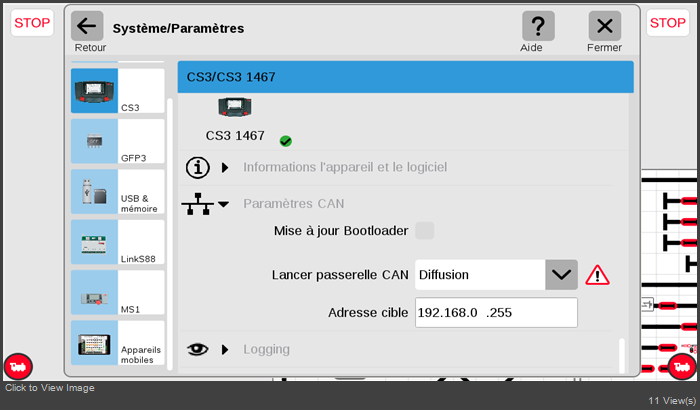

#7 Posted : 29 March 2023 20:12:52(UTC)
Posts: 3,706
Another problem is that I have never been able to find the IP address of the cs3.Crying Angry
The CS3 (like the CS2 has the address you assign to it
In the example below it is 192.168.0.23
It is for instance the address you type in your browser on your PC to get the CS3 home screen like this
(in my case by typing 192.168.0.23)
The answer back address is defined in the CAN screen like here
