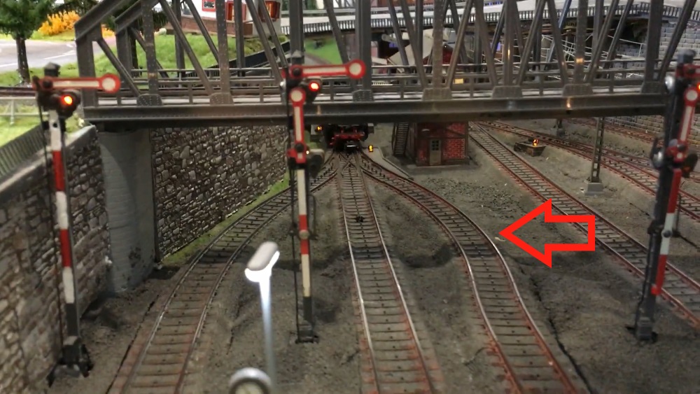

I wsih to bounce back on Miguel's post on how easy it is to modify C track geometry
In this example I had an unrealistic track just after a triple turnout
So I had to shorten one of the triple switch but underneath, the motor was in the way.
So I made the cut after the motor just like this
After filing and ajustment it went like this
And the result is like this now
What I am trying to say is this is easy and take a couple of hours
What is needed in this case
- a cutting disk (I use diamond disk with a Proxxon hand drill)
- a 24630 triple sw
- a piece of R2 curved C track
- a soldering iron
- glue: cyanocrylate + hotmelt

#5 Posted : 23 March 2023 16:37:40(UTC)
Posts: 3,706
Hi Miguel
Because I had a number of old (brittle) C track pieces (1997 or so) I could make some tries just to see how easy it is.
"Imagine you have one track passing in the space of the lever."
Now regarding the track lever mechanism, it looks like this
It is plain to see that if you accept to get rid of the lever and the lighted lantern, it becomes really easy.
I have purchased my set of diamond cutting disks on a flea market in Florida for 5 USD and they last almost forever.
Just take a piece of damaged C Track and try it. It is REALLY easy
