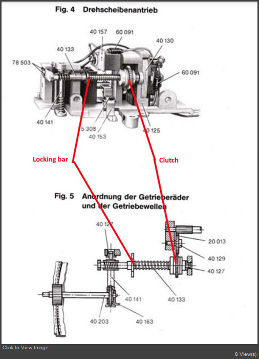

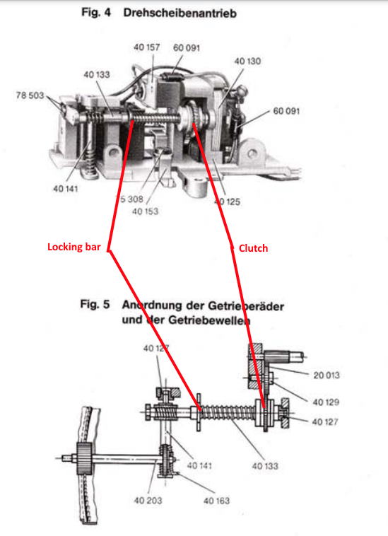

The probable reason for this is the latch / Locking bar (the piece under the rotating bridge) that detects a hole centered on each access track.
Normal operation
- the bridge rotates until the next access track
- the latch enters into the hole centered on the track
- doing so, 2 things happen: (1) the motor is switched off and (2) the latch also locks one shaft in the transmission to stop IMMEDIATELY the bridge (even if the motor continues running. There is a clutch to take care of this.
In your case I believe:
- the latch is entering the square hole (because it stops the motor
- the latch (locking bar) does not go far enough to lock the transmission and to get the bridge to an abrupt stop
- the latch (locking bar) can be unlatched by pressing one of the 2 buttons on the command panel. This activates the solenoid
Here is mine in operation while opened (Identical to the 7186 but earlier "DeLuxe" version called 410NG)
I hope this helps
