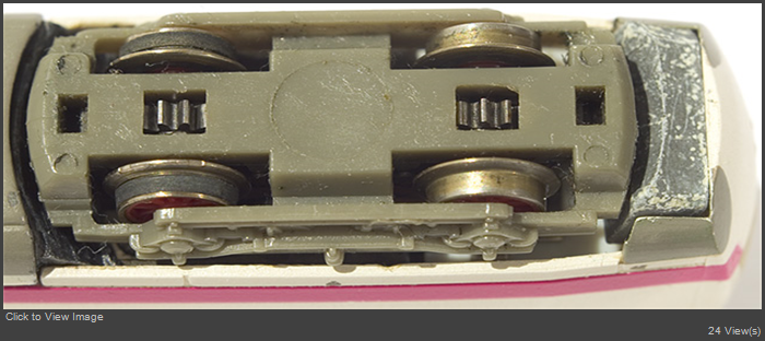

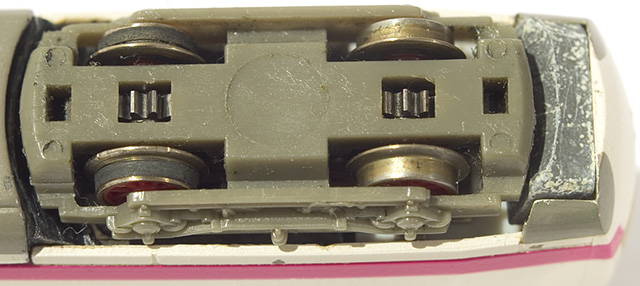

I use heat shrink tube, 2x shrinkage, stretched over the wheel. Don't actually heat shrink it as it then has a more varied wall thickness. I have found it pretty bullet proof other than one time with an excess of gear oil lubricant where I accidentally had a massive excess spill everywhere. I cut off the width with a 10A scalpel blade, being Z gauge getting the exact width is critical, down to 0.1mm tolerance. I am very happy with the result.
