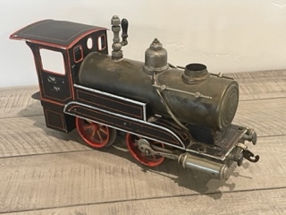

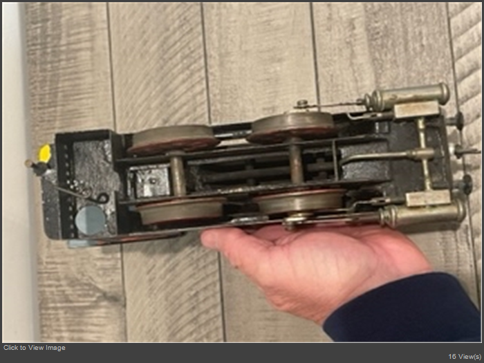

I need help identifying this. I believe it is an early Marklin 1 Gauge. It’s been put away for a very long time. It was a late uncle’s. I know I’ve seen it run….long ago….but can’t remember much about it. I’d like any and all info possible on it.
What is it exactly?
Gauge,
model number,
age,
how it works,
what is it missing,
what does it need to get it to run,
value,
Where to get the things it’s missing….etc.
I thought he said it was a Marklin and it was from Germany. I believe he said it was pretty old and kind of valuable. I would really appreciate any info on it. Thank you all in advance!

#2 Posted : 26 October 2022 00:28:50(UTC)
Posts: 8,544

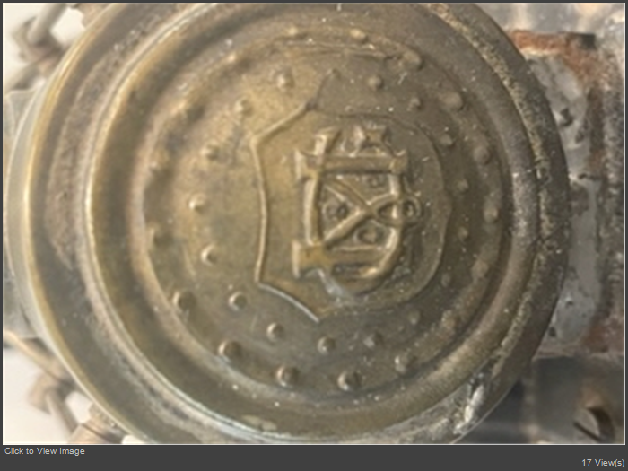

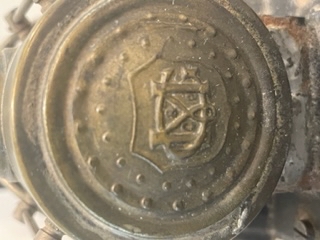

The imprint on the firebox door of the loco in the last photo definitely looks like the Marklin trademark symbol from long ago when this loco would have been made. Beyond that I can't help much, but there are others here who know considerably more about the older items than I do.
But there are some more things you can tell us about it, like what is the distance (in millimeters preferably) between the outside of the flanges on the wheels (i.e. what gauge track it would run on).
Second, this loco would have had a tender, do you have that, or any other wagons to go with it?
It does look to be in good condition, so definitely potentially valuable, but without the tender the value will be considerably reduced from what it could be worth.

I do not have anything else but what you see. I believe it’s around 38-39 mm across the wheels.

Pics of me trying to measure across the wheels.

This was one of the early Märklin logos.
This was used by Gebrüder Märklin (Brothers Märklin) or GM which can be seen entwined in the image.
With acknowledgment to www.sammler-sammler.de
[img]https://www.bing.com/th?id=OIP.zg0OAfS4-wTZtAqmM8MjhgHaHF&w=231&h=222&c=8&rs=1&qlt=90&o=6&pid=3.1&rm=2[/img]
At a guess I would put this model at 1890 -1910.

I'm thinking that would make it an O gauge then, rather than 1 gauge which would be 45mm across the wheels.

I am puzzled with your wheel measurements. The Märklin definition of gauges in mm (distance between rails) are:
- O gauge distance between rails = 32 mm
- 1 gauge distance between rails = 45 mm
- 2 gauge distance between rails = 54 mm
Note: In those days, the distance was measured between centers of the mushroom rail (a little bigger)
So your measurement seems to be between O Gauge and 1 Gauge
Looking into various catalogues I have, the closest model I found was in the 1912 Märklin Bros &Cie catalogue for the French market.
It seems from your pictures, the loco is a clockwork one. Is this true?
The closest loco in 1 scale, clockwork in the French Märklin catalog for 1912 is the B 1031 sold in France for 12,90 Francs (see below top left corner)
Agreed the cabin is slightly different, the chimney seems missing a part and the coupling rod is also missing.
So your loco may be slightly earlier than 1912 and in those years there were variations because these were somewhere between artwork and industrial products
Note: the Märklin logo (Gebrüder Märklin & Cie) on the 1912 catalog is identical to the one you have on the steam door.
In my opinion, the loco is certainly not a later than 1912 model but an earlier one and the cabin look like one for the German market

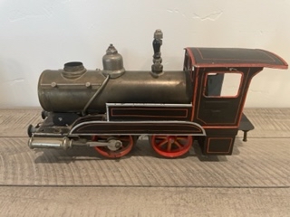

Hello…and thank you for your help. I think it is a steam engine and NOT a clockwork.

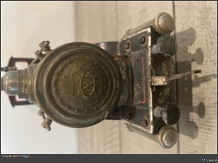

More photos of it.

I could sure use some help identifying
this old beauty. It was a late uncles and I really don’t know much about it. I believe it is a steam locomotive. I do not see any kind of clockwork mechanism underneath. I believe it is missing a smokestack? And also missing the tender?
I do not see any numbers on it. I would also appreciate any ideas of the value of it. It is the only train item left to me and I don’t see a way that I can put a lot of money into a new hobby. So I think it’s best to try and sell it. I am hoping to add to my daughters college savings! Please help me if you can. I would really appreciate it!

Anyway, irs a live steam locomotive, running with real steam.

The logo on the front of the boiler is for Marklin & Cie. (I have been told)

The Loco is a Marklin 4001 running on methylated spirits.
From the era 1910.
Value E 200
I Hope this will solve your problem.

I agree, but available from at least 1904....
4001 = Gauge I (48 mm)
4002 = G II (54 mm)
Hope this helps....

Well….the 4001 models that I have seen that have sold…sold for way more than $200….AND THEY definitely were a bit different. They didn’t have the logo on the front or the hitch thing. Definitely didn’t have the paint details that this one has. I don’t know…but it is similar.
