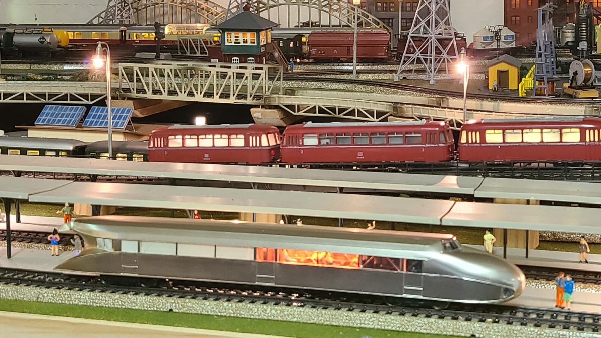

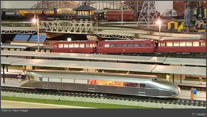

I just got a lovely looking Zeppelin 3477 (will post pics later) that is controlled by less lovely Delta (4-pins) decoder. The train needs 40% to start moving and then goes quickly. It stops like hard power cut; no braking behavior.
Is there a way with modern Marklin (or PC RocRail) digital control to improve the driving/stopping characteristics using the current decoder. Yes, I can always put a new Mfx AC 60906 decoder in (or replace the entire insides with DC motor+decoder), but it seems more fun to try and tweak the original (if possible).
Thoughts? Experiences with 3477?

Thanks Ross. I added interior lights and peeps as you did, but not yet an AC motors decoder upgrade. The current Delta decoder seems sluggish compared to others I have.
