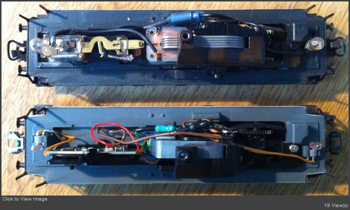

#13 Posted : 03 October 2022 02:28:22(UTC)
Posts: 3,687
Hi Eino
Like it has already been said, the key for you is to open the loco and look at the brushes
Here is a picture of two of my Märklin V100 locos
The loco on the top is the older design with LFCM (Large Flat Collector Motor) where the 2 brushes, one made of copper fabric and the other one of carbon are CYLINDRICAL and parallel to the motor's axle
The loco on the bottom is the newer design with DCM (Drum Collector Motor) where both brushes are carbon, rectangular section and moving TOWARDS the motor axle.
If your Loco has a DCM motor then very easy:
- either you use the COMPLETE set 60760 (a five pole motor and a simplified decoder)
- or you install a motor 60941 and a decoder (or the one you already have)
If your loco has a LFCM motor then it gets more tricky:
- you use a Märklin motor 60944 and a mlLD3 decoder or your decoder BUT you WILL have to adapt SIGNIFICANTLY the magnetic circuit to fit into the loco. This is a risky operation
A handdrill (Proxxon Dremel) and a cutting disk is needed for this task.
Here is a top view of each V100 type
As you may see, the loco on the top is the old design (LFCM) with a THIN magnetic circuit
The loco on the bottom has been modified by Märklin to include a 5 pole motor and a much THICKER magnetic circuit (so adapting the 60944 motor may pose priblems).
- another alternative is to use an ESU magnet (51960) for this kind of motor with your decoder
Here is the 60944 motor user's manual with the list of compatible locos and the V100 is NOT on the list (pages 5 and 6)https://static.maerklin....98976096f51557844893.pdf
I hope this will help

The solder tags are Marklin part number E231470
#24 Posted : 22 October 2022 00:30:00(UTC)
Posts: 8,614
As for the ground connection, the motor kits, and I think the 60760 kit, usually comes with a brass solder tag which is meant to be fitted on one of the motor screws in between the magnet and brush plate. When the screw is tightened up, this gives a good grounding point to solder a ground wire to.
Normally the solder tag is under the head of one of the screws holding the brush plate on.
Soldering directly to a screw won't last, the wire will come off and I'm not too sure about soldering to the chassis - you would need to remove paint to get a decent solder point.
You would need a blow torch to attempt to solder to the chassis as the bulk of metal will conduct the heat away too fast for a normal soldering iron. It is not the correct type of metal to attempt to solder to anyway.
#25 Posted : 22 October 2022 07:55:00(UTC)
Sometimes the solder tag on the motor isn't enough. For my Marklin 3153 and 3353 BR 120 locos the solder tag on the motor isn't enough grounding because the wheels on the motor bogie all have rubber tyres so the ground contact patch isn't that great. The solution is to drill a small hole in the loco chassis floor and fix a solder tag to the floor with a short self tapping screw that doesn't protrude beneath the chassis too much. Solder a wire to that tag and the other end to the motor tag. That improves the running of those locos out of sight!
thanks 6 users liked this useful post by Bigdaddynz
Offline einotuominen
#26 Posted : 23 October 2022 11:33:00(UTC)
einotuominen
Joined: 19/09/2022(UTC)
Posts: 464
Location: Kaarina
Yes, this is why I automatically ditched the idea of attaching ground connection to the engine, even though the manual instructs to do so.
#27 Posted : 23 October 2022 20:28:06(UTC)
einotuominen
Posts: 464
Location: Kaarina
LEDs are working aswell. I had 5mm LEDs which are absolutely a nightmare to fit in, but managed to do it. Got to get smaller LEDs in the future!
Thank you guys!
-Eino
