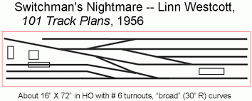

Time for me to do something in a different scale as I would like to make a “Switchman’s Nightmare” by Linn Westcott in Z scale. Please see picture below. I have zero experience in Z scale so I would like to ask, is this feasible or is this scale too small to shunt freight cars?
The other question I have is which is the better Z track, Märklin, Micro Trains or Rokuhan?
Your help in this matter would be greatly appreciated.
Regards, Michel

#2 Posted : 01 September 2022 23:19:38(UTC)
Zme
Joined: 02/10/2013(UTC)
Posts: 897
Location: West Texas
Hello, hope all is well.
I have never tried to create the switch “nightmare” you are inquiring about, but would think it is possible to do this in “Z”. There are many options with the Marklin brand of track.
I hope you find the z track plan document information useful for this. I can see the basic shape of your picture is perhaps similar to those shown on page 45 but add a few more switch points.
https://www.maerklin.de/...Buch_Spur_Z_komplett.pdf
There are different opinions about who makes the best track I only have the Marklin track and can tell you it takes longer to install because it must be ballasted. Even with this, as stated earlier, there are many options with the track pieces. I cannot say the same amount of options are available with the other track brands. It is nice when it comes with the ballast, but many also say, they don’t like the fake plastic look which you get. In this regard, it is your preference on how you want it to look.
Hope this helps. Take good care.
Dwight

#4 Posted : 02 September 2022 10:42:23(UTC)
Carim
Joined: 15/09/2014(UTC)
Posts: 705
Location: London
I certainly do it and I have also seen exhibition layouts were it has been done. I have only done it manually and the main shunting exhibition layout (using American couplings) I have seen also does it manually (use a cocktail stick or small screwdriver). The key is to be patient and go gently, it is quite easy to derail light wagons. I tried a couple of 8587 uncoupling tracks, but they don't work very well for me - so I won't bother with getting any more.
Carim

Offline Poor Skeleton
#9 Posted : 03 September 2022 23:20:54(UTC)
Poor Skeleton
Joined: 09/10/2015(UTC)
Posts: 601
Location: England, Cambridge
Regards, Michel
I know it has been done, but I don't feel Z scale is well suited to switching/shunting. Decoupling is a problem, as Carim has mentioned, and slow speed running isn't really up to it, either. Even with something like the Snail controller, the risk of dirty track continuity problems makes satisfactory running unlikely.
I love Z scale, and it has many attractions, but I fear you'd end up hugely frustrated if you try this.
Chris

Offline Carim
#11 Posted : 04 September 2022 15:27:33(UTC)
Carim
Posts: 705
Location: London
I think there is a simple solution to this debate. Get a few bits of track and one point, a controller, a loco and 2-3 wagons. Then set up the track like a "Y". Place your wagons on one arm and then using the loco, take each wagon over to the other arm, reassembling your train in the opposite order. This will tell you whether, given your setup, a shunting layout is feasible/enjoyable.
Carim
