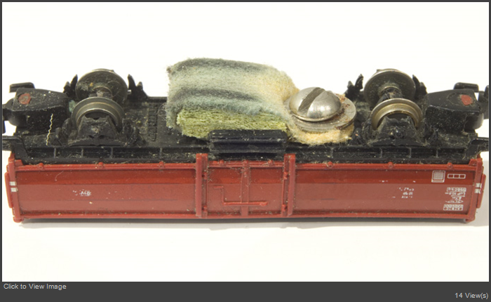

I filled this wagon with a block of lead and tow it around with two heavy locos. A bit of cleaning cloth wrapped around 2 layers of Wettex kitchen dish cleaning cloth/sponge https://www.vileda.com.au/cloths/wettex-wet has about the right pressure on the rails.
You can get a lead diving weight from a diving shop or large fishing weight, bash it with a hammer or use jewelry rolling mill. A wood chisel to cut to size. Re hammed to fine tune dimensions.
Screw taps into lead, if keen tap a thread.
I have had no issues pulling it over points. Dab it on paper towel to clean sponge.
