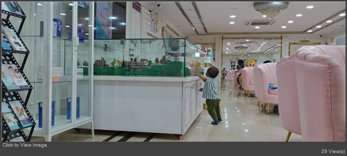

#13 Posted : 23 September 2024 16:30:55(UTC)
madhu.gn.71
India
Joined: 16/04/2014(UTC)
Posts: 775
Location: Bangalore, India
I almost forgot about this thread. Let me post the pic of the final result. I set this layout in my friend's clinic on Oct 29 2023. I had designed it in 3 modules of 2 ft by 4 ft size. I used my old MS2 and used two of my Startup locos on this layout. One is BR89 from Haribo set and another one is the Fire Engine train set. It was an absolute fun building this layout. My 11 year old son worked with me on this layout. As per the feedback received by the clinic receptionist, the kids love it. I have instructed them to run the train for not more than 5 minutes at a stretch. The layout is kept in a glass casing as shown above.
thanks 6 users liked this useful post by madhu.gn.71

Very well done Madhu, an excellent result. I must say i was a bit worried about your previous posts given the very sporadic nature of power supply in this country! I had thought maybe battery operation was the way to go, but then thought maybe a pediatric clinic would have a backup power supply, which i guess is the case?
Hope to meet up with you sometime?
Charles in Goa
thanks 2 users liked this useful post by scarfo
Offline madhu.gn.71
#15 Posted : 23 September 2024 17:36:07(UTC)
madhu.gn.71
India
Posts: 775
Hello Charles,
Thank you for the lovely words! The clinic does have a stable power supply and a backup too. Additionally I've used a spike buster (if that is of any help:)). I'd love to meet you too. I've heard a lot about you from other model train enthusiasts in India.
Madhu
