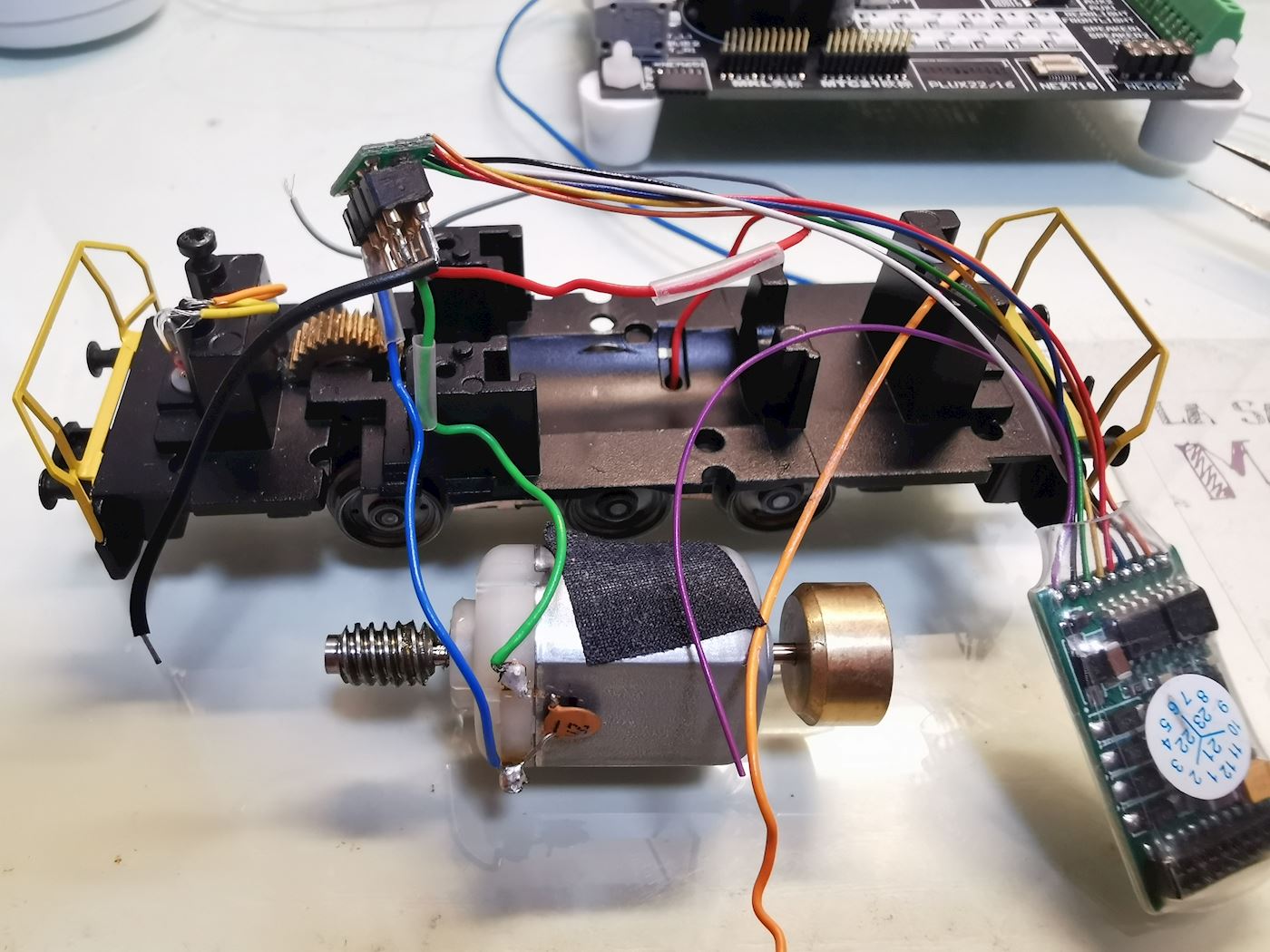

I bought a Trix locomotive DHG500 (21523). This is not DCC ready and I planned to convert it into a DCC locomotive.
I thought the task was easy in the first place but it turns out to be difficult. The circuit keeps on short whenever I switch on the DCC power. However, the locomotive can operate smoothly if a blank plug instead of the 8-pin decoder is inserted.
Could you let me have a solution or if there is any tip for such conversion.

I did resemble pickups and motor wires but it still doesnt work. Only hissing sound can be heard when I turn on the power and start the engine.

I'd like to see a better picture of the plug and the socket.
I guess the wiring is wrong on the socket.
When you plug the decoder in in the wrong way, both motor connections will go to the motor and both power connections will go to the power connections and no harm will be done.
It looks as if you have both motor connections on the same side and both power connections on the same side.

The conversion is ok now. The problem has been fixed.
IMG_20220626_001934.jpgIMG_20220626_002140.jpgIMG_20220625_234156.jpgIMG_20220625_234244.jpg

What was the problem? Swapped wires? Something else?

Pickup left and right swapped.
