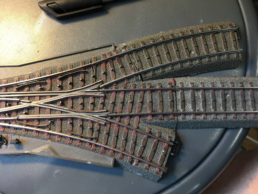

So I have been digging around and can't seem to find any threads with the same issue, but I have been experiencing a frustrating power loss with most of my 3 Way turnout (C-track 24630s)...at low speeds (shunting speed and most of my 3 way turnouts are in the shunting yard) I get a power drop, but only when the turnout is in the LEFT turn position. It is not a short and a little nudge and the loco keeps rolling...it would appear the slider is losing contact of the studs, and it is driving me crazy! I don't want to run locos dangerously fast in the yard and I also don't want to keep getting up to nudge my locos, it is killing my "flow" to keep stopping like this! I had 1 recommendation to install the "stay alive" capacitors, but that gets expensive and a lot of extra work and another to maybe use conductive paint on the frog/blades..?
Any one else run into this? Thanks Josh

The tracks are offset. The original M track 3-way switch had a common frog and was symmetrical. This has resulted in slight differences in the space between studs, depending on which direction the train is heading. The left turn (yellow) has the longest spacing between studs, which may be the reason why it is more prone to problems.

Jean - Thanks for their depth reply! I have looked into most of these issues and to answer your question from your other reply:
All my locos are Marklin, most of them fresh from overhaul and decoder installation, so the sliders are mostly newly replaced or in good condition and fit (flat/straight etc). Any of my locos that were manufactured in the last 3 or so years are not prone to the same error that I am having with the rest...I believe they either have "stay alive" capacitors installed, or they have the new style of sliders with no hole/indentation like the old style ones. Having spent about an hour earlier running various locos it appears that they are stopping exactly at the point with the indentation on the slider occurs when the loco going forward for backward across the left turn. In the picture (in my reply to mike c) I have circled the stud/pukos at which this occurs, every time.
At slightly faster speeds this is not an issue, but I currently have a decent sized marshaling yard and love shunting operations (when they go smoothly!) but at realistic speed, this is driving me crazy!
I love your videos and love that you have a "real" hump yard on an incline with the uncoupler track placed there, brilliant!
Thanks Again and I will keep you updated on my "fixes", Josh
Mike Thanks for the reply, yes its always the left turn and it seems to over and over occur when the slider reaches the (left turn) stud I have circled in your picture. It without fail occurs when the indentation in the slider crosses that stud and the power drops! My newer locos are not prone to this as they have the sliders with no indentation or have a capacitor.
Other than operating faster than I would prefer I guess I can add capacitors?

Posts: 3,697
Hi Josh
Below is what I believe and I may be wrong
Here is where you loco stops
You may see clearly that the contact stops when the slider recess (w. hole) is in front of the green oval stud and this is normal. What is not normal is the current feed should be provided by the studs behind (closer to the point)
Here is the top view of the switch
The studs on the right should make contact with the slider.
I can't see on the picture but beware that some studs are made of plastic so, make sure the contact is with a metallic one
One thing is sure: there is no design error and I don't observe any stops on my 24630
Of course with a slider without recess, the pick-up is much improved. It is possible to swap the slider shoes from one with recess to another without but keeping the spring and fixation part of the one with recess.
Notes:
- of course pick up a new slider shoe of the same length
- extract the shoe by opening slightly the buckle to extract the spring blade sideways
- to screw back the slider anchor you will have to push aside the shoe
- sometimes the problem may be caused by an unbalanced push by the 2 blade springs
- I never had to swap a slider to correct current pick-up issues.
I hope this helps
