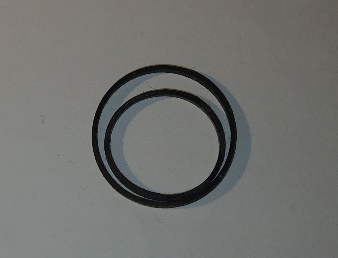

On my 39027, the original traction tires were a bit uneven
here is a video on how it was before I replaced them: (the roller test stand makes it very visible, but even en on normal track it vas visible.)
https://www.hovland.net/filer/39027_s.mp4
After I replaced them, the driving improved and become normal.
But when I received the new spare traction tires I noticed that the spare traction tires listed by Märklin are quite a bit smaller in comparison to the original ones fitted. So instead, I used E225024 as they are closer in size to the ones originally fitted from the factory.
This picture shows the original compared to Märklin listed spare part E656520.
And the new 39491 (DSB E 991) also has the same "jumping" running behaviour, so I'm going to replace the traction tires on that one as well. Ans it sounds like the flange is touching in part of a wheel turn. so that also indicates that the rubber is not above the flange and gripping the track.
Anyone else who has noticed the same uneven traction tires?
And why the difference in size, original vs spare part? possible error?

Thanks for the answer, it got me thinking a bit more Smile
My 39027 traction tires did not have a visible twist/roll, checked that first, but I did not use a magnifying glass. And looking at the original tires does not reveal any obvious fault/damage.
I also notice that several users on stummiforum.de have also reported similar running behaviour with the 39027 and replaced the traction tires.
I tried to swap tires with an IV h, 26922 (listed with the same spare traction tires as 39027), but the traction tires from 39027 did not fit the wheels on the 36922, the rubber was a bit wide so it did not settle properly in the groove, so I abandoned that. and the IV h tire was a bit hard to get on the 39027, and seemed to stretch too thin. That's part of the reason why I decided to try E225024.
Sho could the reason actually be that the original traction tires for the 39027 are slightly too large? causing the traction tire to grip along the edges of the groove and causing an uneven stretch, and subsequently small bumps ?.
I don't have spare tires for the 39491, so I will wait to investigate that properly until I have the spares on hand. It's a bit delicate locomotive, so I will try to minimize its handling of it. I have a propper foam cradle, but it still has the risk of breaking some fragile parts. might take a while.
