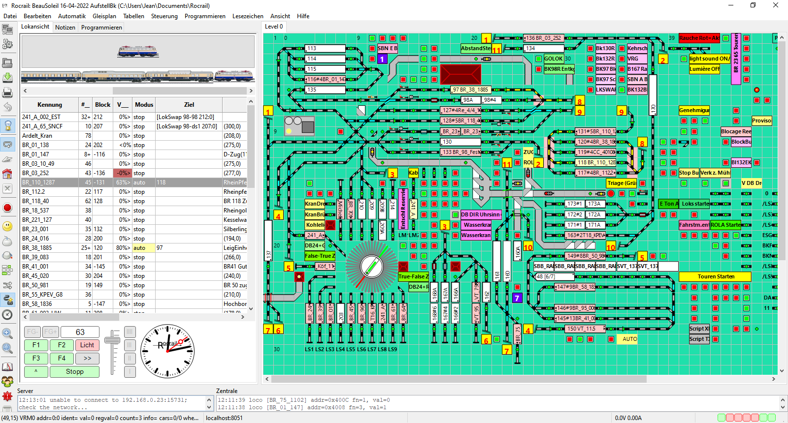

I am a huge fan of Rocrail. Better than words here are videos of its possibilities
- steam locos in depot
- Classification (Hump) yard
- car system operation
The track layout may look like this
