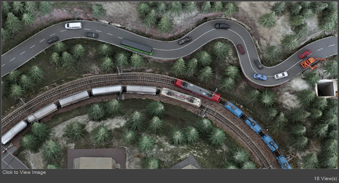

Offline Toosmall
#7 Posted : 28 March 2022 21:46:37(UTC)
Toosmall
Joined: 26/07/2021(UTC)
Posts: 635
Location: Sydney
I have an S Bend on my layout, but it is subtle & looks good. It is a mountain scene.
thanks 8 users liked this useful post by Toosmall
Offline Mr. Ron
#8 Posted : 28 March 2022 23:14:03(UTC)
Mr. Ron
Joined: 05/07/2020(UTC)
Posts: 326
It looks like you have some straight section in between the curved track.
thanks 1 user liked this useful post by Mr. Ron

I believe every layout needs a bit of straight track & a few S bends to look better than your mistress (as a boat moored near us is call 'Mistress Again', when they sail her on the weekend they give her a good hammering and score medals!)
Even better, add a few S bend roads, it looks good and roads are easy to spray out of 150ml touch up cans with grey, white and black pre heated, pre mask the white road markings with Letraset if you can still get it or finely cut masking tape.
How would we drive through the Italian mountains without a few switchbacks and serpentine hill climbs?
Good shots Toosmall!
