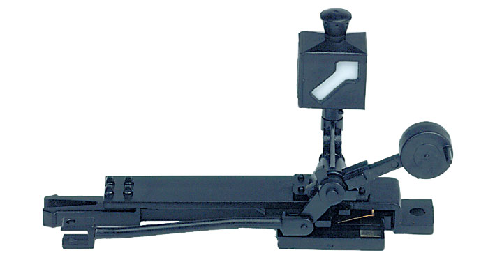

What do you use as lantern near your c and k switch?
Any alternative to the 7547 or 74470, just looking for a different look

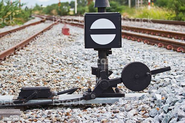

I think I will look more into the possibility of extending the neck of the already functioning Marklin lantern.
Too bad they don’t make the HO gauge one as good looking (IMHO) as the I gauge one (see pic below)
The mod should be simple enough since the lantern is movable from the base

Yes something I had thought about as well but if considering this there is also the issue that due to the Marklin point design (spring mechanism to allow trains running over points in reverse) that the lanterns are in the wrong place in any case.
Therefore I think you either use the Marklin K/C track turnouts and lanterns, or use something like Piko track (ie code 100 for K track compatibility) with added centre studs and then use prototypical lanterns connected down at the end of the tongue to the same servo connection for the drawbar.
Alternatively you could also stick with Marklin points but gut the spring mechanism design and connect a servo straight to the drawbar and attach the prototypical lantern there as well (such as Weinert).
Overall its a fair bit of custom work to do so not really worth considering I think unless you've done everything else to the same high standard.
