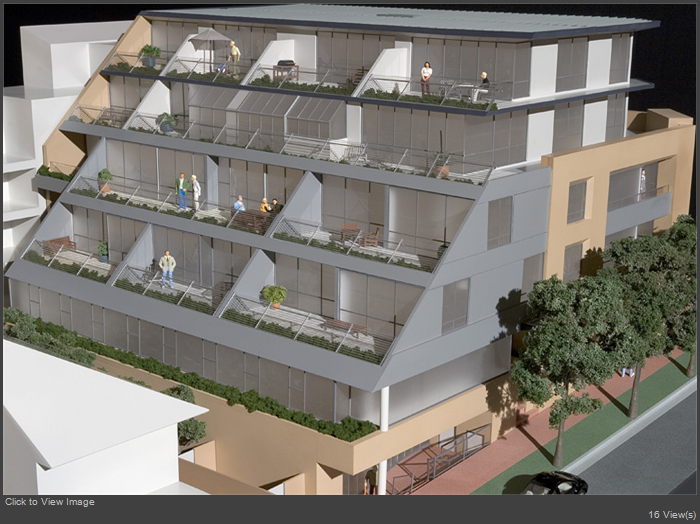

If it is for modern windows you can make them up from Evergreen styrene strips. It will take longer than buying but at least you can build exactly what you need.
A thread on solvent I use, some of my architectural models.
https://www.marklin-user...sts/t27449-Glue-question
What I normally do for frames which is good enough for architectural models. Maybe not enough for a train layout model. Is score lines into 1mm polycarbonate sheet and then rub kids acrylic paint in, using a cotton rag is the best. Tip, put some masking tape on your finger first.
Usually you can do a whole wall in one go. Fit polycarbonate to the wall, mark window openings with scalpel. Then score lines on work bench.
A model from the 1990s, 1:100 scale, 1mm polycarbonate, scored, black window frames, spandrel panels, green tinted glazing (back sprayed green acrylic lacquer) and matt sprayed back of glazing so you can't see into model, but it looks light. Put window sills on and custom etched balustrade and panels to design.

Here is the overall model. It would look good on a large city HO layout!

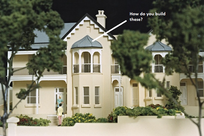

Hi, I am very interested to hear about your building techniques - thanks for all the tips. In the picture you posted, how do you build the curved roof (could you even show us a few photos of how to go about it)?
Do you have any other tips to model complex curved shapes (those that curve in different ways on the x, y & z axes)?
Thanks, Carim
Thanks, Carim
A bit like this:
I build it up from Forex (expanded PVC). In this situation it was built up in layers a bit over size and sanded. Then made a silicone mould to make copies.
These days a 3D printer would be better.
I will start another thread on base contours.

Certainly nothing happening like in the first image! The marketing people loved it, people would look closely at the model then burst out laughing.
