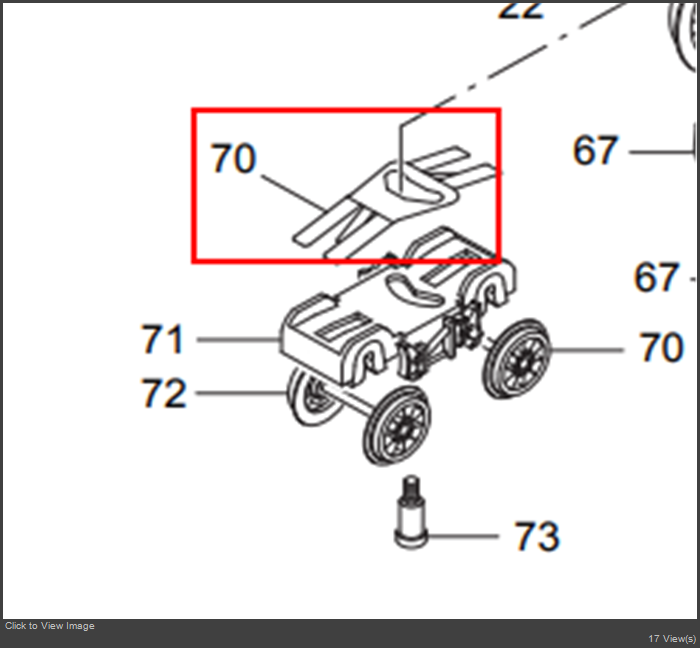

The other question I have is why is their a brass power pick up thing on the front sets of wheels on the tender of 39010 as I saw this when I was removing the loco body as I thought no power went to the Tracks.

Regarding current pick-up Märklin on almost all its steamers includes a metal blade to spring the front bogie and also to be in contact with the axles. Same with the trailing bissel (Laufgestell). This is to improve current pickup return while the current pick-up is made by the slider.
Here is the spring blade on the bogie
