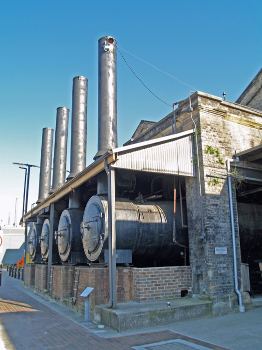

The workshops and the roundhouse had a lot of heavy equipment that needed to be run - this used to be steam driven, and of course later electric. Also, a handy supply of steam could be used to warm-up a locomotive that had dropped its fire. In cold climates steam pipes could also be used to heat outside areas to keep them clear of snow by running pipes in the ground.
Here's a static steam plant at the old Eveleigh locomotive workshops in Sydney, which is very obviously built from locomotive boilers:
http://www.australianste...36%20class%20boilers.htm
Sometimes an old steam locomotive would be parked next to the workshop and used as the static steam plant. I can't find a photo of one right now because I can't remember the German name, but I think it was Faller that made a model of this to put next to a roundhouse or workshop, with an extra long smokestack attached and then steam pipes from the loco into the plant. Maybe someone knows the German name for this?
