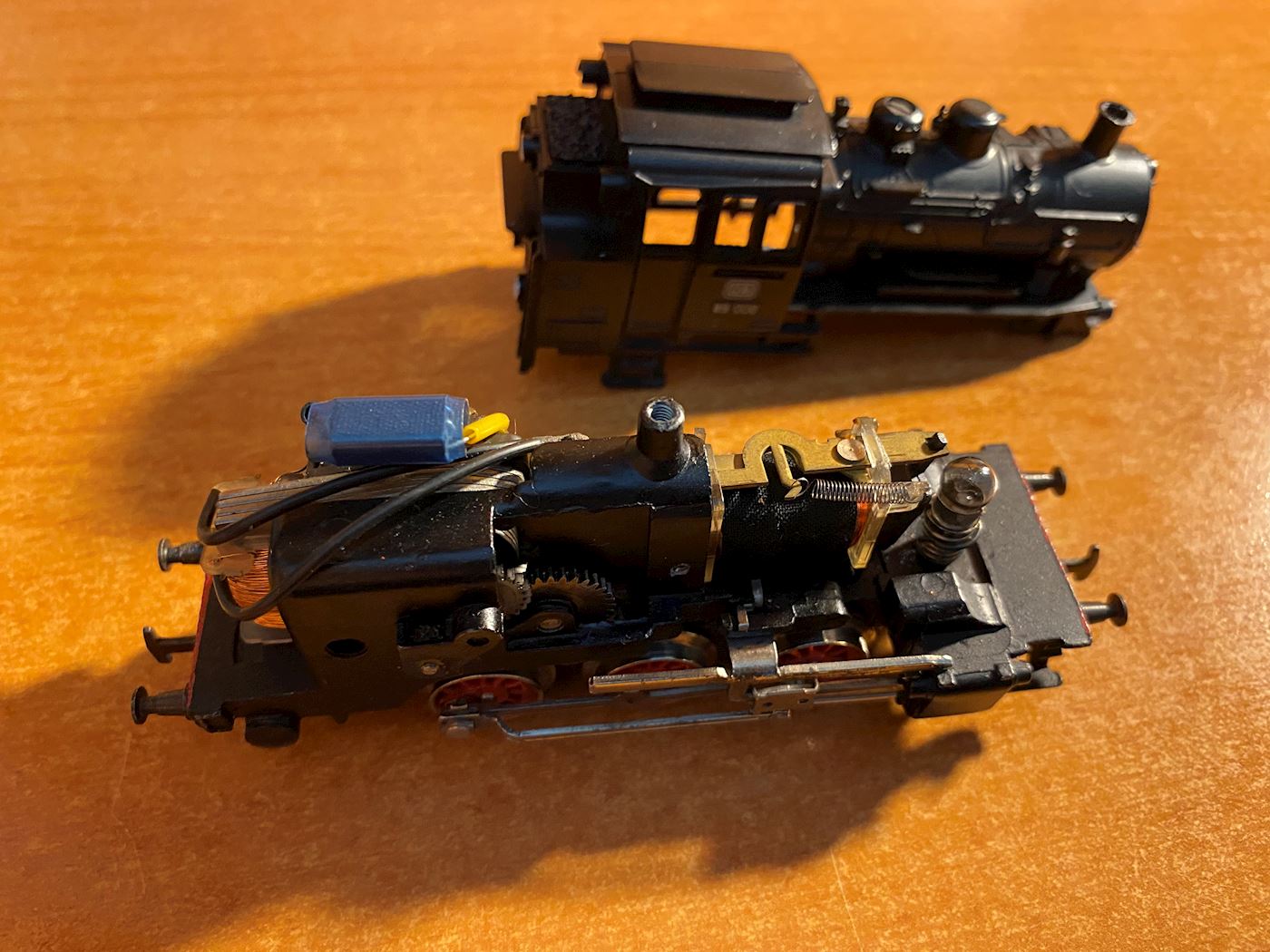

This is my sweet locomotive. I think it is really old at least it smells old to me :)
thanks 2 users liked this useful post by berkgenc

Your locomotive is indeed a classical analog BR 89. Enjoy!
