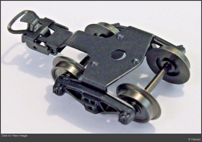

The Marklin Spare parts list for this set lists two wheel sets (Radsatz) of which E700190 appears to be the three rail (Marklin) set, and E700600 appears to be the two rail (Trix) wheel set. each part number is for 2 axles at 6 Euro a pair.

They do not only seem to have that, they do have trucks made of metal, and non removable couplers. I see no other way than mutiliating the trucks (by "clipping" the couplers) and glue NEM pockets (e.g., SYMOBA products - see link below) to the underbody in which you can insert Kadee couplers. My recommendation: I would sell the tin plate freight cars.
SYMOBA (German website):
http://www.symoba-schniering.de/sym-produkte.htm

I'm suspecting (but I'm not 100% sure) that the bogies are made of metal, and that there's no insulation between the bogie and the wheels. Here is a picture of the E323110, which is the bogie spare part number for these wagons (there's another spare part bogie listed - E322890, but I'm not sure what they correspond to).

Yes, I came to the same conclusion.
I have not bought them yet, so ... I'm not going to.

Spare trucks:
E323110 = tin plate box car
E322890 = tin plate caboose
