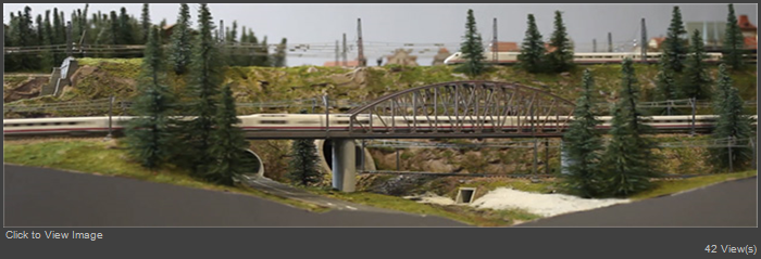

This is a lot further ahead of these photos, but still needs work. I built it two decades ago but it's been gathering dust. It has been more in the way than anything but due to the effort I put into the design I couldn't get myself to get rid of it.
It was designed to fit in a space and our previous car. The car has changed, the house space, one could say has shrunk, not from moving. I will leave it at that!
Anyway, the two ends can be joined together to reduce the length to 2.3 metres. The station is 0.4 metres, it's a lot of work for a short section, but that was due to our previous car as two 1.35m modules would have been a pain in the neck. I could add another module to extend the station if I had nothing else to do!
The frame is welded aluminium 38 x 25mm RHS. 25.4mm aluminium legs slot in, with locking custom nylon thumb screws. The RLs (relative level) are made from Forex (expanded PVC mostly 3mm thickness, solvent is Tetrahydrofuran SLR laboratory grade 99.5%).
Earthworks are built up with polyurethane foam, being careful not to do too much in one go. It expands a lot. Then cut back the excess foam to create open cells and covered with typical railway model materials. Track ballast was made from three colours to give variation.
The fly-through is the main line only without additional station tracks or loading yard tracks at rear, or 400mm centre module. The layout is basically two independent layouts in one, clockwise and anticlockwise. I prefer to run trains, couldn't be bothered fiddling with shunting. If one loop fails then there is a good chance that the fully independent second loop keeps going.
Uphill is on the outside, radius is 287mm 2% gradient, hence the crossover to keep uphill on the outside. I learnt a lot from my first layout, so no curved points or crossing points. The basic design was a sort of dogbone folded into three but then looped.

ICE fly-through screenshot. The bridge concrete columns I made from styrene as I didn't like the bought ones as they looked a bit tacky. Added a bit of "rust" to the bridges, slack maintenance!

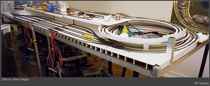

My first layout, full of disasters, before I know better.
3.6 metres long. The two halves fitted upside down into each other, unscrewing the Lichtenstein Castle (not shown) on the mountain, to make a compact enclosed box for transport. That compact aspect was the only good thing about the layout. On the new layout I got rid of curved points, and no cross points ether.
The track was on a plywood base with 6mm aluminium tube spacers between it and the layout base. The ends of the aluminium tube tapped so is was all bolted together to the correct RL (relative level). A lot of work, but at least it made the whole layout very rigid and didn't move when filled with polyurethane foam for the earthworks. It worked really well. Track was on foam ballast which ended up disintegrating. Grass was the pre made sheet grass.

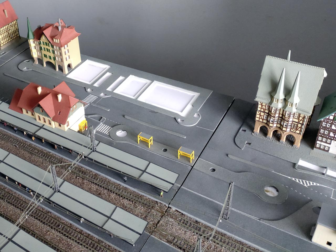

Slowly progressing. I cut all the footpath pieces. They key into the road and the buildings key into the path. It is easier to paint this way and everything is positioned exactly.
Nothing is glued in yet. Will stick on the people, street furniture and growies, last will be the buildings so as to keep them out the way while positioning the small items.
