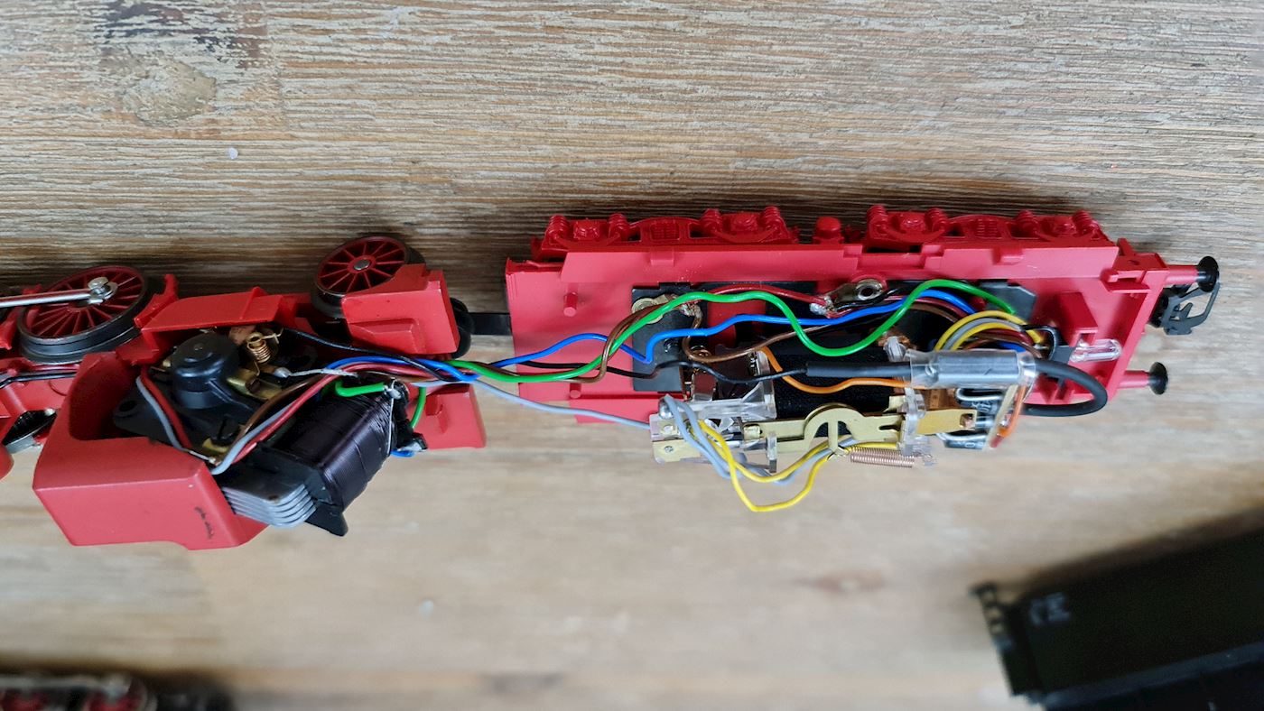

I have a Marklin BR 041 334-4 steam locomotive with number 3392/3792 and when placed on track connected to central station 2 or mobile station 2 it continuously runs.
I do not know what to do or look for. Opened the loco and it does not look like a decoder. In the tender there is like a magnetic switch device. 20210716_080027.jpg20210716_080035.jpg

What you have is an analogue loco, to use it with digital you will need to upgrade it. It will need a motor kit and a decoder to get optimum performance.
There are threads with conversions of various locos that you could use for a reference, and there are plenty here who can advise the best option for decoder.
