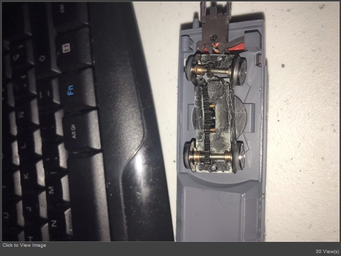

Hello all,
Another model from Märklin is presenting problems with Zinkpest. This time is the 37501. I have used this model only a few times and today I decided to run it and it was stock, one side of the driving set was not runnig. I decided to make an inspection and after reviewing I saw the problem it is Zinkpest in one of the bogies of the motorized car, the other bogie is perfect with no sign of zinkpest. Actually the boige came apart when I inspected it.
This will be my third model with the problem. Until now I have had this issue with:
36805 Koff green
37521 Seethal brown
37501 DB 420
I am attaching some photos for your reference and I have sent an mail to Markln Service. Also, I did some research in the Stummi Forum and the problem has been discussed since 2019 when some members also found their models damaged. Some of the members in the Stummi have indicated that Marklin has repair the train for around 105 euros plus shipment. I would be more interested in getting the replacement bogie but in the parts databese of Marklin the it is not available.
I will let you know what Marklin responses.

#2 Posted : 13 June 2021 02:55:28(UTC)
Posts: 9,728
Hmmm.. I expect that the rear and front bogies were made of the same stuff - I would be trying to get both bogies replaced by Marklin..

#3 Posted : 13 June 2021 06:03:45(UTC)
mvd71
Posts: 1,972
Location: Auckland,
If it is zinkpest I would expect Märklin to replace it at no cost. It only occurs because of a poor quality casting.

Hi, send the bogies to Märklin an d see what will happen. Very likely they might send new ones at no cost.
