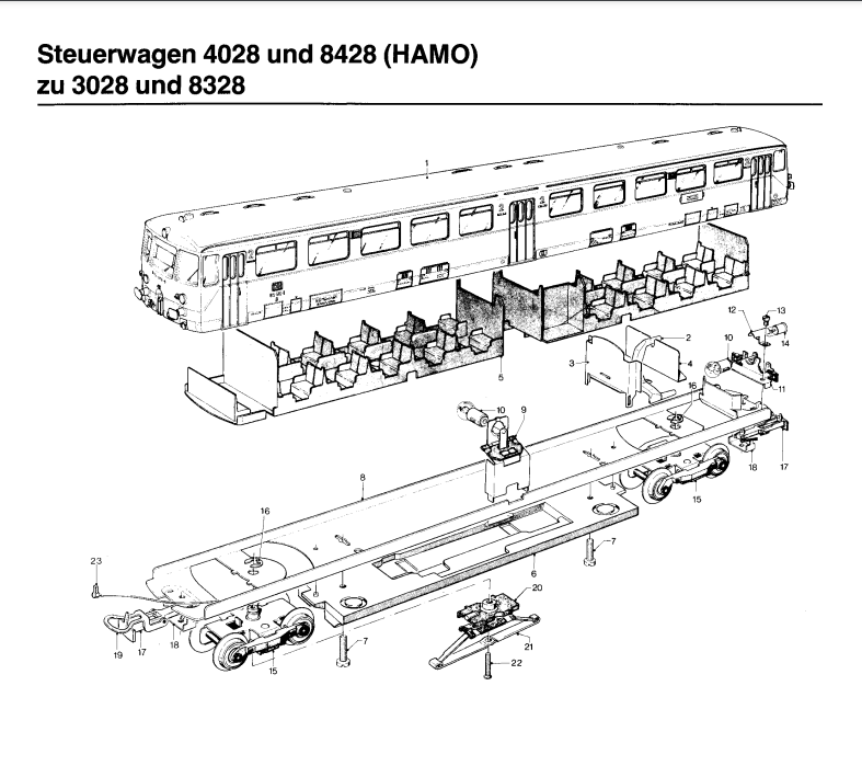

#3 Posted : 31 May 2021 20:18:09(UTC)
Posts: 3,687
Hi Stefano
It seems that the trailer (4028) receives the power from the slider in the 3028 motor unit and there is a "Schleppschalter" (trailing contactor) to change the lights (White / red) depending on direction
As confirmed also on the 1984 catalogue
Here is a newer version of the schleppschalter on control coaches
Principle: a contact spring attached to a wheel axle makes contact with one contact or the other depending on wheel rotation direction
#4 Posted : 31 May 2021 20:25:49(UTC)
Posts: 15,541
No, there is no "Schleppschalter", there is a special MRU that also changes the lights in the powered car. The wire from the powered car controls the white head light in the control car.
The control car has a slider for the interior lights and the red rear lights.

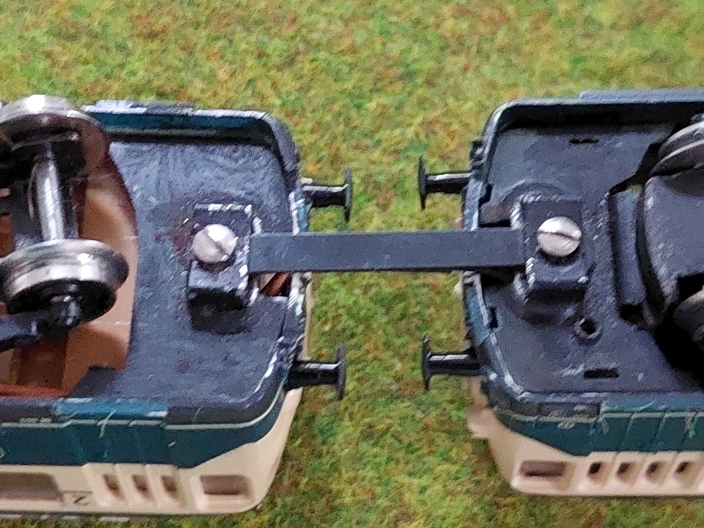

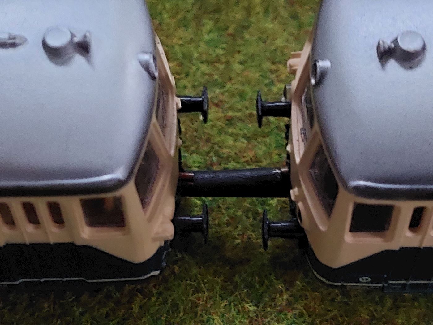

Offline Joop V
#5 Posted : 31 May 2021 21:49:47(UTC)
Joop V
Joined: 21/03/2021(UTC)
Posts: 14
Location: Noord Holland
As you can see I have the same modell , permanent connected.
The wires for the interor and rear-lights are in a heat shrink tube to make it look discrete.
Just make sure the wires have enough space to move otherwise the bogies won't be able to turn and derailment will follow in the next curve.
