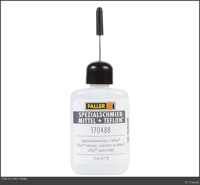

I mostly use the Faller "Teflon-öl", but it of course fails on the local availability issue. Even use it for door hinges, locks and such at home - works very well.
I think a fully synthetic 5-40w or thinner motor oil would be rather ok also on plastic gears, but I will stand corrected if I'm wrong. Smile
