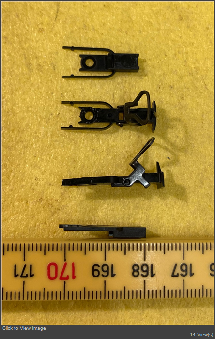

I’m planning to add lighting for two sets of 41xx cars. Based on Internet suggestions (somewhere), I purchased some Märklin E323679 adapters or ”shafts” to enable NEM couplings. However, I find the plastic of E323679 shafts is too thin: The couplings will therefore drop too close to the track. On the pic below, you will find the E323679 shaft at the top and at the bottom. The mid second and third items are the original shafts and couplings. Also, the E323679 shaft plus e.g. a Märklin E115737 current conducting coupling provides a unit which us too long. The distance between the cars will be bigger than the original...
Would you have another suggestion of NEM compatible shafts? Or should I simply give up on the 41xx cars, maybe sell them and go for modern lighting-friendly cars instead?

Oo errr. Hmm. I'm in the same boat, I have some 41xx series cars to go with the 'Longest train in the World' NS coaches, along with their 42xx versions, and want to do the same as you, putting lights in the 41xx coaches. The 42xx have the close coupling mechanism, so they are fine. It may end up being a case of putting up with the increased distance between coaches anyway as they are not close coupling mechanisms.
Are the E115737 couplings the ones that come in the 72020/72021 kits or are they the fixed drawbars?

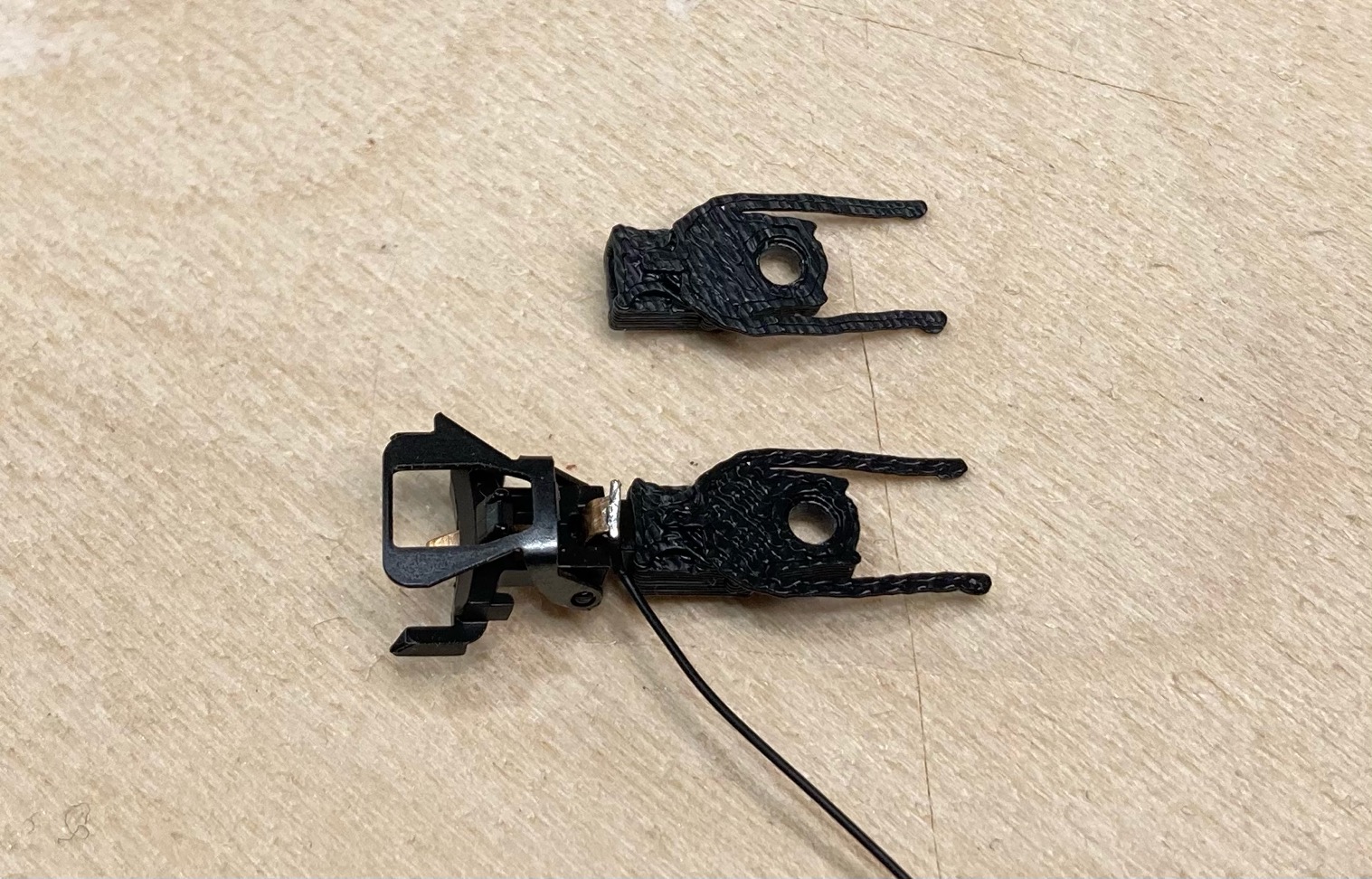

I have received the adapters from ”Mobadapter” as described above. They are probably 3D printed items. I installed LED’s using Märklin E115737 current conducting couplings. The combo fits well, and they seem to be working great. In the first pic below, you can see the adapter without and with a coupling, including how I solder the cable to it.

Hi PeFu! A quick question on your coupler solution- if you are running those couplers with 1 pole current, how are you grounding the LED strips from car to car? I know they cannot use track ground if they are on an independent circuit?
I am in a similar project and have a great circuit, thanks to Dale here on the forum!, but I'm struggling with a reliable 2 pole (wire) coupling solution that is small/clean enough looking. (and affordable!)
Thanks!
