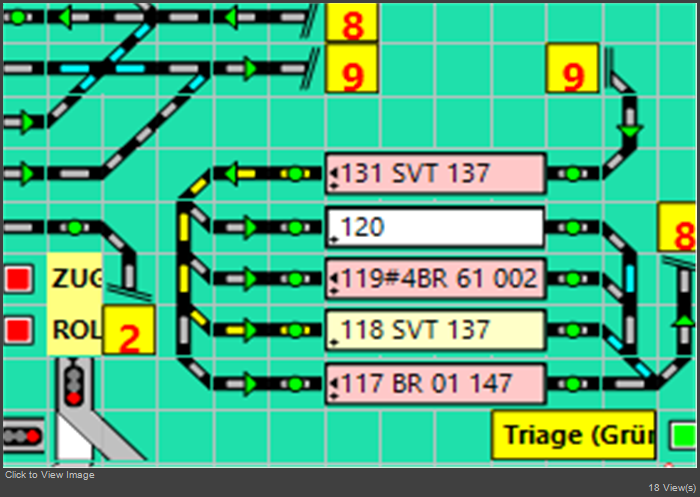

  • When you set your loco in start (right click on the loco) does a destination shows?
    This is a portion of my plan where the loco "SVT 137" is presently in block 131 and when setting it to run, it decides to go to block 118

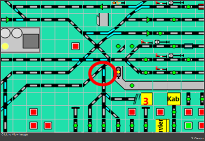

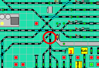

#8 Posted : 04 May 2021 15:53:00(UTC)
Posts: 3,721
Originally Posted by: luckas Go to Quoted Post
All my turnouts are working, although the track plan switch icons do not always reflect the correct position, even though they are addressed correctly and work as expected.
Hi Paul
Sometimes, due to the angular position in the track plan, the position is shown incorrectly (Has to do with using right switch instead of a left switch). This is normal an all you have to do is invert the switch position Right-click on the switch, go to interface and tick the invert box. Verify that routes using this switch are setting it correctly (otherwise go to table/routes, select the route and then commands.
Here is one situation in my layout where I had to do just that (circled switch in red)

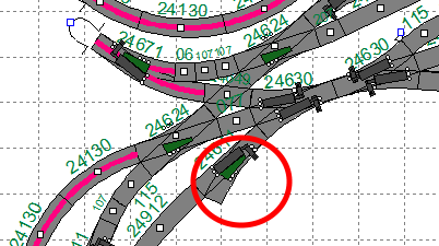

Here is the real track design
You will see the needed switches, select the one with problems, select modify and change its position (right, left, straight, thrown). Validate
Offline luckas
#9 Posted : 04 May 2021 16:13:07(UTC)
luckas
Joined: 06/02/2002(UTC)
Posts: 198
Thanks Jean,
Have you ever seen a situation where when you click on a turnout, it changes, but it also changes the icon in another turnout at the same time? It doesn't actually switch the other turnout, it just the indicator?
Paul
