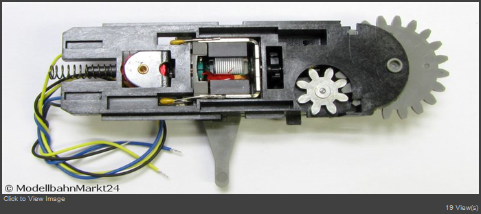

Hello.
I have a Fleischmann 6652 platform that is compatible with the Marklin 7286 and it started making an abnormal noise in one direction of rotation until the motor stopped running. Swap the motor for one from sb modellbau and it runs just three steps one way or the other and hangs. I could see that the finger stays in the groove of the sprocket and does not return. Could this be due to gear wear?
Can someone tell me if the part 05060521 (see attached file) is valid for this platform. I have asked Fleischmann but they don't answer me.
