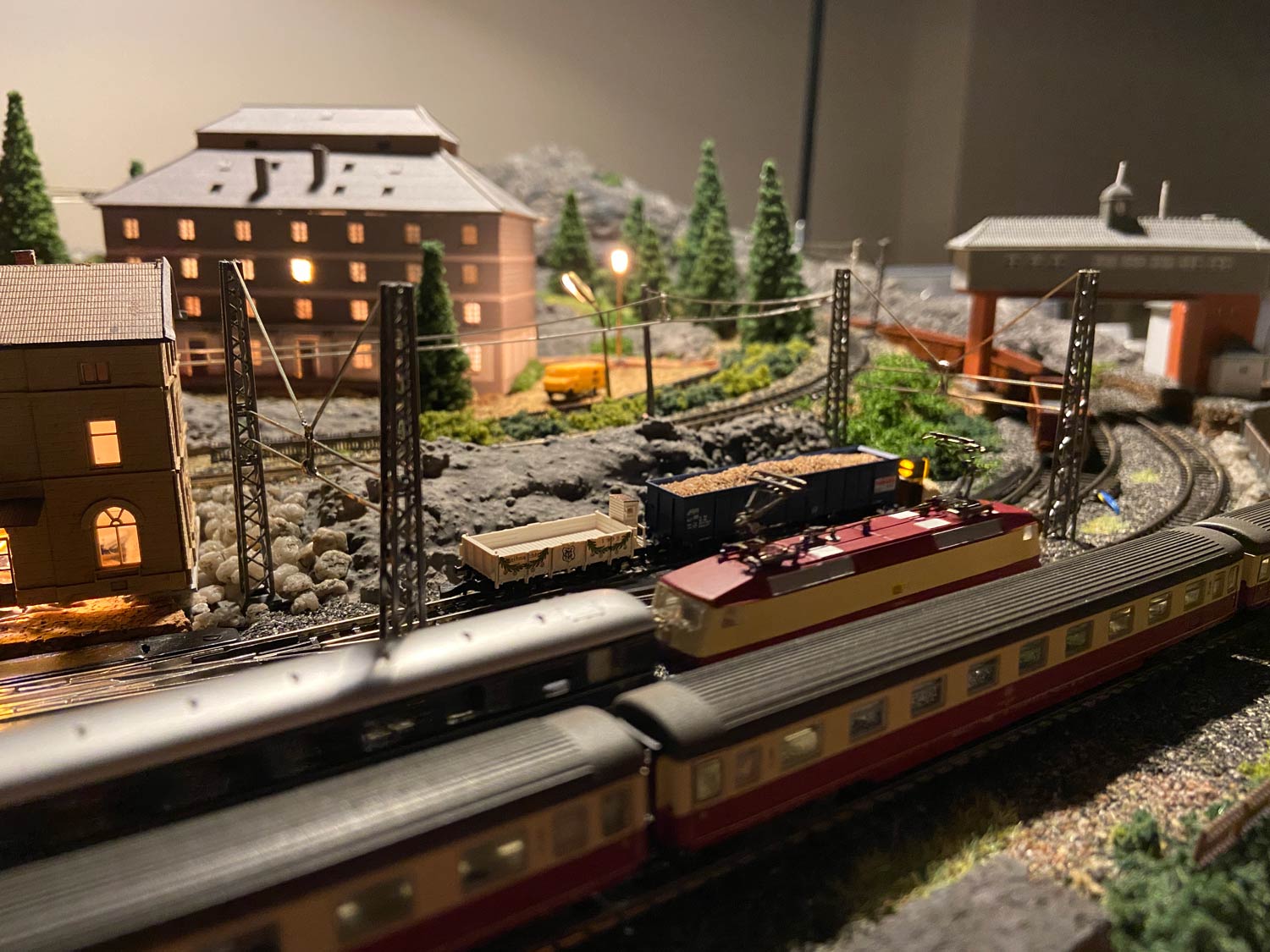

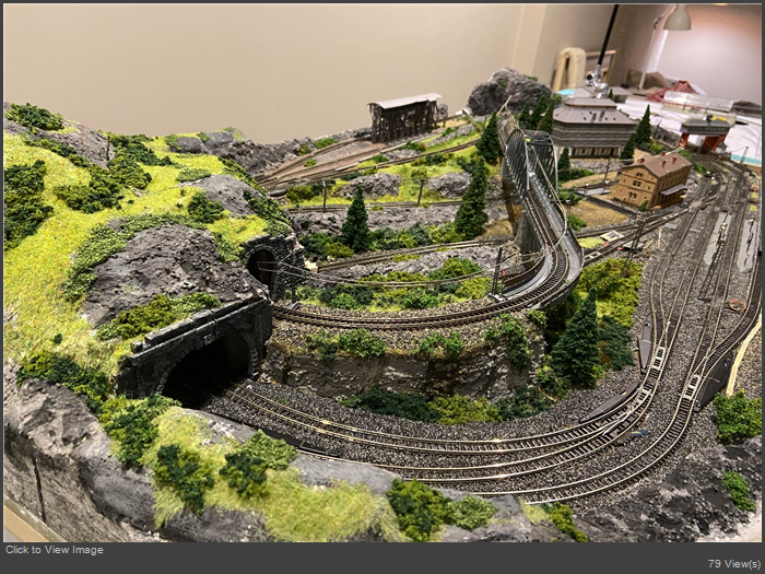

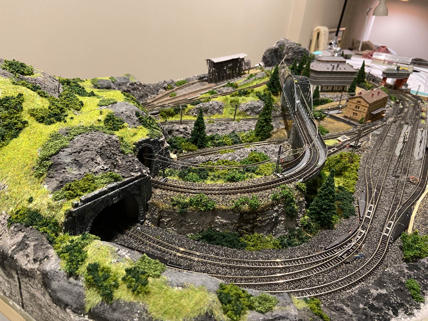

My first Z scale (any scale for that matter) project, aptly originally titled Project Z, is at completion stage and I'm hooked.
Below are a few images of my progress.
So I move on to my next project/s, of which there are already 3.

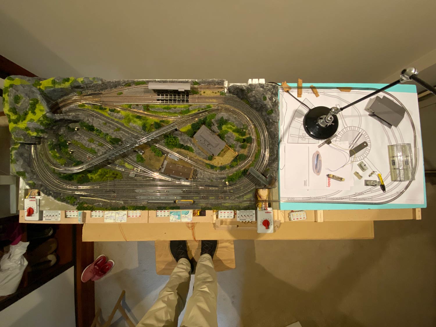

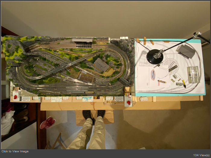

1) An extension of Project Z by way of an added module to instal the Marklin turntable.
2) The setup of a DCC test track to try and 'get into' DCC.
3) The building of the 'Little Gem' project featured in the 2021 Marklin insiders magazines.
1) Should be fairly straight forward. I've learnt a lot already in my relatively short time in Z.
I read some forum comments that suggested modules were the way to go (as one is never satisfied with just a small oval).
I was fortunate to have two sidings facing the same direction and almost at the end of each side of the board.
And I can just squeeze a module onto my work desk.
I figure a turntable should be fun as I find shunting trains around quite therapeutic but I don't have space for a fiddle yard.
In the images you can see the early completed Project Z, and my layout plan for the new module.
I've seen some YouTube posts recently with wonderful ways of linking bus wires and joining tracks between modules.
Needless to say finding such goodies doesn't seem so easy in Z.
Can anyone suggest the best way to easily attach and detach tracks between modules?
