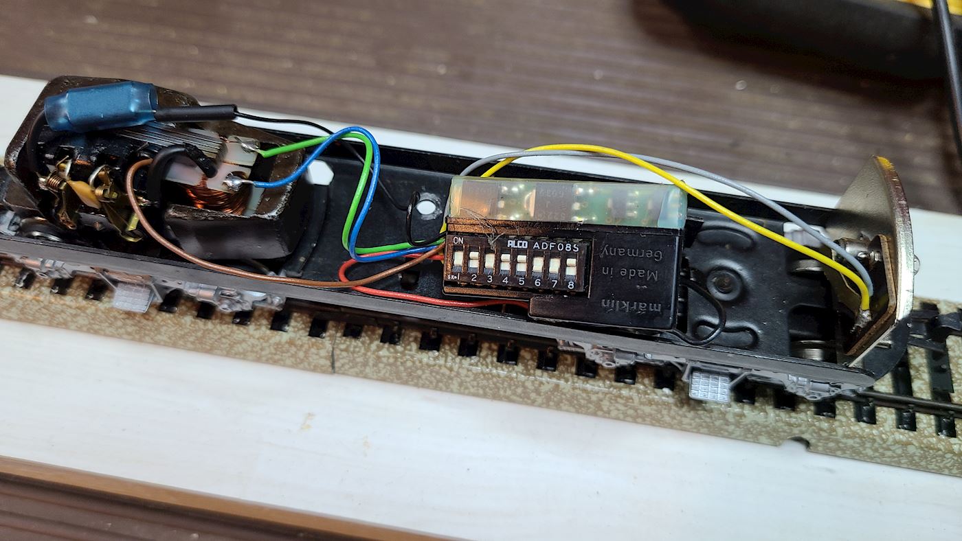

Just got a 3060 Santa Fe via eBay and noticed it was a digital version, so direction switching without familiar buzz and spring. I am all analog otherwise and just want to know how to get the front light to work when moving. Bulb is good (tested), but no idea what the dip switches do that are connected to bulb socket. Is there a manual for this?

Quick photo of the decoder installed may help, but some models the decoder does not allow the function to work in analogue and others have it working all the time.

If you are only going to use it for analogue then turn all switches to the OFF position. It sounds like someone has fitted a 6080 decoder or possibly a 6090 decoder. This will be an aftermarket fitting.
The early decoders did not turn on the headlight when run in analogue mode - but I don't know what happens when the switches are set all off, it may then turn on the head light, but I cannot recall any documentation about this.

Thx for fast response.. Here's a picture of the inside.
Alternatively, I can perhaps power the light from the shoe, like the dummy. How should that be wired?

All switches off made no difference. No light, but unit still reverses.
Decoder is 6080.

I connected light to shoe with extra wire while keeping decoder in place (off). Lights now work. Running analog with white transformers, so no fried electronics.

Since posting, i converted 6 trains to digital and learned a lot. This unit has early 6080 decoder with little control. Works fine, but basic. Lights not controlled by decoder. Newer decoders allow programming with 6021, instead of switches and dials of this and 6090 followup. I may upgrade decoder in future, but more display unit then use. In case you wonder, I am not interested in post 6021 controllers, maintaining some vintage authenticity.

These decoders are called C80 and are both analog and digital-capable BUT, in analog the light is not driven (only in digital mode).
