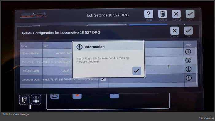

I hooked the wireless router to CS3 and tried update loco decoder firmware. It pops the following message and I cannot proceed. Any idea?

The CS is not a mind reader.
If you select a class of firmware to update (checkbox) - it also helps to select which version to update.

If I select only some but not all updates, it still says I miss a flash file.

IMO you must have a pretty good reason to update a decoder on a loco except on mSD3 and mLD3 decoders when you sometimes MUST to connect to the mDecoderTool3.
Did you get anything in the right column, it looks empty.? if there is an update for your locomotive it will show in the right column.
Not all locomotives get updates, eg my 39030 have firmware 3.0.0.17, but there no updates for it.
and my 26922 locomotive has received an update from 3.0.1.0 to 3.2.1.0
