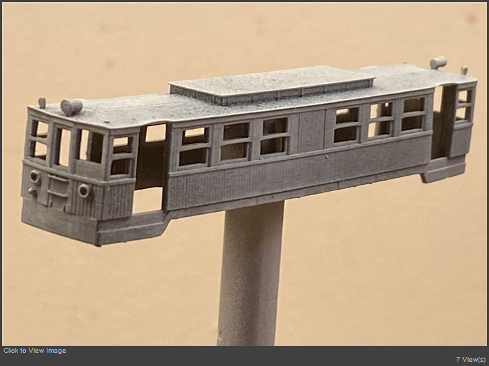

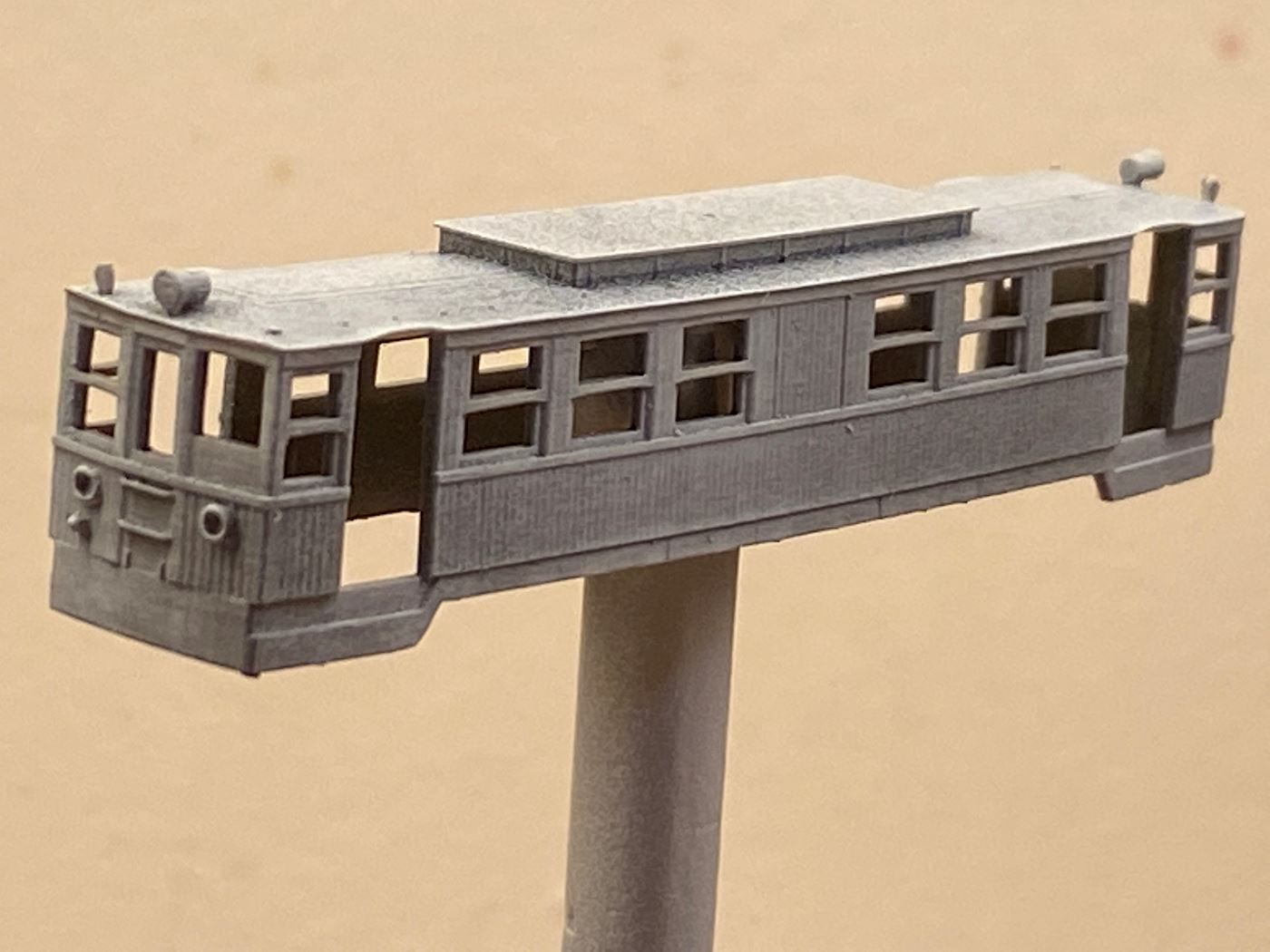

Very much inspired and encouraged by Al's success in 3D printing locomotive shells, here is my first print attempt at a body shell for one of the locomotives of the Ferrocarril de Sóller in Mallorca on which my layout is loosely based.
A few refinements still to do and then the challenge of powering it (I have a Shorty chassis on its way to me) but I'm very happy with this first attempt.
Hope this is of interest
Chris
thanks 5 users liked this useful post by Poor Skeleton

Very cool! This 3D printing stuff is magic to me, I have no idea how the “drafting” is done. But what you have there is a nice shell and great looking loco.
Thanks very much for the kind comment. The printing process is something I'm still getting to grips with, but I have managed to get a few usable pieces out of it so far! As for the drafting, the way I do it isn't a sophisticated process!
