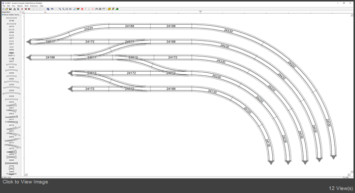

Hello everyone,
I a new to SCARM and I think, I joust found a bug.
The 24430(R4) and 24430(R5) are not alined with all the other tracks.
All the R1/R2/R3 are working well but not R4/R5.
I do not think it should be like this, all radius should aline perfectly.
I am doing something wrong or is it an actual bug?
Thanks!

It’s not a bug in Scarm. Track distance between R1-R2-R3 is 77,5 mm, and between R3-R4-R5 it should be 64,3 mm. To achieve this, the easiest way is to use 24711/24712/24771/24772 turnouts instead of the 24611/24612 turnouts. If you google you will find several drawing examples of combinations. You could google e.g.:
Märklin c gleis 24711 geometrie
Etc...

Ok thank you so much! I didn't know there was that difference.
