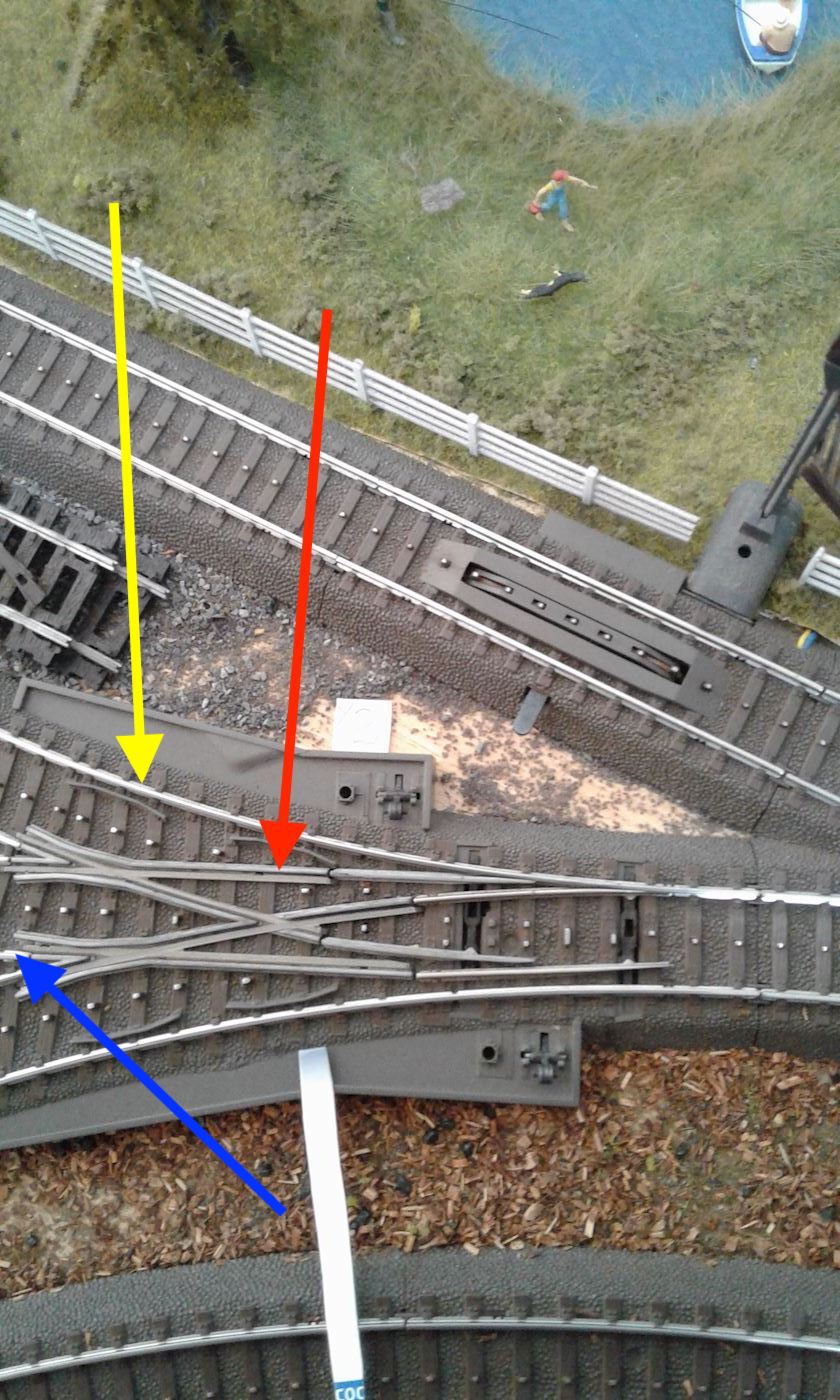

Ive had my 39302 diesel ML 2200 since 2011. Such a lovely looking loco!
It runs fine, altho ive found that the track and pukos really needs to be scrupulously clean! The only hassle I'm having is when she runs very slowly over my 3 way turnouts (I have 2 of these) there's a loss of contact...I've looked carefully under the loco and it looks as if the front of the slider is touching the side of the rail??....I've been told to fit a shorter slider?!?!..is this possible?Confused .... if I run at a fair speed it just momentarily hesitates but does carry on thru the turnout.....
Stay safe out there folks Sad
Joe M from a cold wet wintry Cape Town
Medium digital C track layout with MS2: When I grow up I want to be a steam engine driver....

Hi Joe. Make sure the slider is fitted properly to the loco and that there is not too much sideways movement. If it is only when going in one direction over the three way turnout then check that the movement does not have any small bit of grit stuck there.
I expect you have probably done the above but if not worth trying before changing the slider.

Are you sure it's the slider? I had a coupling at the front of a loco that clouted the raised centre studs / pukos in the middle of a turnout / points every time travelling in one direction when leading. It looked like an electrical hesitation but it was mechanical.
C track?
If the slider touches a powered rail there will be a short circuit and the controller will eventually go on STOP.
With C track the rail near the frog are not powered an no short circuit will occur. So the slider touching the rails should not normally be a problem - unless the slider is bent out of shape and loses contact to the centre-rail studs in the event.
Thanks David....slider firmly in place. It has 4 locating lugs so no sideways movement. No grit or dirt that i can see....
IanC
Thanx Ian...I have removed the couplings...still the same....if the speed is very slow the motor cuts out, lights go off, a slight push and it starts up again....Confused
C track?
Thanx Tom....... the slider is not bent out of shape. It happens on both my 3 way points as it enters...but all of the other turnouts, curved or straight, are fine...Confused
A slight push forward and the lights and motor go back on again.
At higher speed settings there is enough momentum to carry the locothru the 3 way with only a slght flickering of the headlights....
Stay safe!
Joe
IanC
This suggests you don't get a short, but rather that the slider gets to a point where it is not touching any studs.
make sure the slider is dead flat along its length.

Hi Joe,
It may be a lack of ground. With the power up, get the lok to stall. Take a jumper wire from any ground source; rail, trafo, etc. then touch the other end to a driver wheel on the lok. If the lok lights up, it's a dead ground spot on the 3-way switch.
Just a hunch. Let us know.

That is excellent advice. ThumpUp I have found many new Märklin sliders to be bent up in the middle, which invariably causes turnout problems. I have also found that just a very slight adjustment to make them perfectly flat makes most of the problems go away!
I check my problem sliders for being flat, evenly suspended front to back and side to side and also for the proper mm drop below the wheels, and then most of the time the electrical gremlins go away. ThumpUp

Thanx everyone for all the advice.....slider dead straight ( checked with my 6 inch rule), and firmly in place. Tested with a jumper wire when the loco stops, as per Mikey, but nothing happens unless I touch the wheel wifh a fair amount of force, which moves the front of the loco sideways and then it powers up again.....the same happens on the other 3 way.....
I tested all my other 19 locos and they are ok except for my old 3309 BR 85 (converted to digital a number of years ago)....it reacts the same as the diesel loco....at slow speed it stops as it enters the 3 way...a slight push to the side and off it goes again.
solution? Run the diesel at a fair speed and it goes thru the 3 way with a slight hesitation....
Joe

In my experience with K track the sliders don't need to be perfectly flat. The only problems I've had are with the older style sliders with the hole in the middle to access the screw.
The newer Marklin sliders have a bow shape to them and the Lilliput sliders have a flat middle and both ends are bent up at about 5 degrees or so.
Both work fine on my large K track layout of all switch types.
I also have the Glaskasten with a 7cm long slider and it has no problems with the long slider.
Joe what you can also do is with the jumper wire again connect one end to traction power and then (carefully) with the other end reach through the wheels and touch the slider.
If the slider contact is the problem it should then move.
I am assuming it will since you've use the same test for the wheels to earth and it made no difference.
Unfortunately I don't have a C track 3-way to look at but there will always be a contact point with a slider and the studs...
Right! Got to the spot where loco stops. Just as it enters the 3 way. I had connected a jumper wire to the slider beforehand. Touched one of the centre studs and loco lights up!! And off she goes. Same in reverse. Loco stops at the "dead spot", touch the centre stud an powers up...
Now....how do I go about rectifying this?!?!Confused

Thanks for that David...I have the number E226495 for the replacement slider. It has 4 connecting lugs that hold the slider body in place? See my post to Eric a short while ago....
Never been very happy with my two 3 way points. I could of course redesign my shutting yards by replacing them with "normal" turnouts....I've had a few folk tell me that they love my layout design....but not the 3 ways....not realistic enoughBlink
I'll see if I can utilise a slider from one of my spare locos....thanks!ThumpUp

Before you do that I would also do some checks on the 3-way. With a multimeter do all the pukos show voltage? Can you pinpoint exactly where the slider loses power and the culprit puko?
You might be able to just mechanically fix the issue.
Otherwise in your situation and without replacing your 3-way turnouts you have two choices:
1) as advised replaced the slider. You say only 2 of your locos have this problem, so should be rather easy.
You haven't posted pictures of the slider so I don't know what it looks like and its fitment but if its a screw in slider then the Brawa slider 2225 should fit fine and resolve the problem.
2) add additional contact at the dead spot. You can either add a puko by drilling a small hole and add a loop of thin copper wire bent over at the top and then underneath connect it to traction power.
Or you can use 0.2mm steel wire as a 'bridge' across 2 or more pukos, again connect to traction power underneath.

Are the Puko's sticking up high enough near the rail. I guess yo know they should be slightly above. I have M track and have had to make adjustments on occasions to suit some locos, even though most work without a problem.

Thanks Eric. I've put up pics of the slider and the 3 way. My paper marker indicates where the loco stops. There is no screw in these sliders. Just little lugs that clip into place. It seems to me that the slider is missing the pukos at that position. At speed the momentum will carry it thru....
Going to try and add wire as a bridge....see if that helps....

So, I thought I would take a run at this...
I don't have any of the 3 way switches (K or C). I am wondering whether the track section at the point of the red arrow is metal or plastic?
If that section of the track is plastic, it is possible that the locomotive is getting insufficient ground return contact as it passes through this section, resulting in the locomotive stopping if it cannot maintain sufficient ground return with the other rail.
As the locomotive passes over the switch, especially if it is heading for one of the outer tracks, the force pushes the locomotive towards the rail at the outside of the curve, which might reduce the contact with the other rail which maintains a better ground return. I am curious whether there is an issue when the locomotive is travelling straight, when both wheels are in contact with the middle section?
So, here is what I would check. Test the conductivity of the middle section (red arrow) to the outer rails (yellow arrow) and to the inner rails at the end of the track (blue arrow).
As far as the locomotive is concerned, perform a similar test, checking the conductivity between the left and right wheels of the slider bogie and between the left and right wheels of the motor bogie. Are the wheelsets uninsulated, so that both sides are in contact even when one side is not directly touching a metal rail? Also test to see whether there is conductivity between the slider bogie and the motor bogie, to see whether the ground return is maintained even when one bogie is not contacting the rails?
You can also test this by putting the locomotive upside down in a locomotive cradle and contact one wire to the slider and then connect the return to each wheel to see if all serve as proper return. It may be that the model has universal axles and the wheel contacts are supposed to be joined inside (wiring) to create the ground return (compared to DC models where the model would have separate plus and minus leads).
This may help or it may not be of any use, depending on how the model is set up.
As far as the switch, you can test the middle section by running a DC (Roco) coach with lights (slider added) and install the isolated wheels so that only one side serves as ground. If the middle section is powered, the lights should be constant. If the middle section is not powered, then the lights would go out when the return is no longer completed. I have equipped Roco coaches with lights and insulated wheelsets, rotating one wheelset so that each rail is connected to the return. Once this is done, those coaches can no longer be used on 2 rail DC because it would create a short. Restoring such a coach to it's original insulated setup will result in only one rail per bogie serving as pickup, ideal for this kind of testing.
If it turns out that there is a conductivity issue between the centre section and the outer rails, perhaps this can be reinforced by soldering a wire from the centre section to the outer rail?
