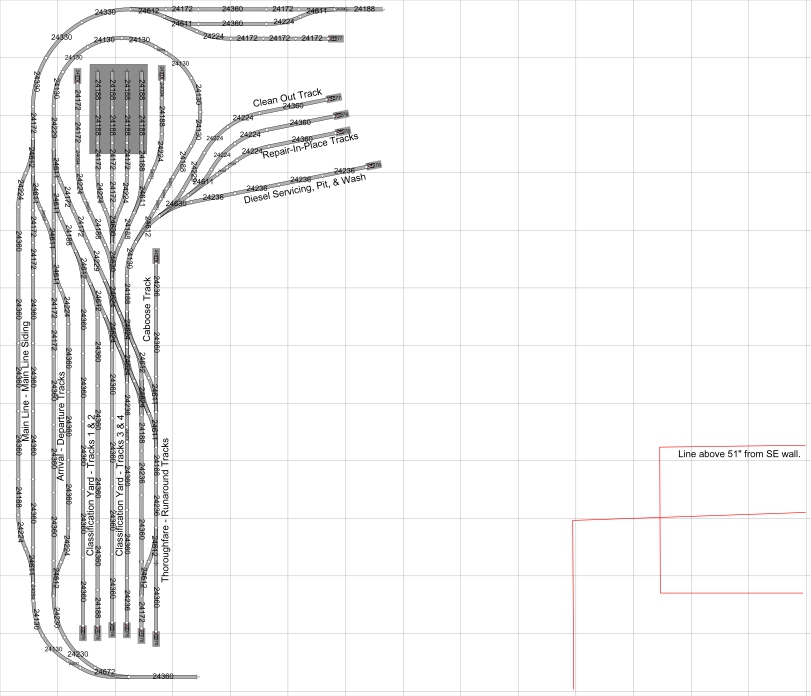

Hi All,
I've been tinkering with AnyRail after reading a book: "Guide to Freight Yards" by Andy Sperandeo and finding jpgs of a full freight yard online. Using his insights & the jpgs, I came up with a "full freight yard" plan for a 12 x 14 foot room in HO scale. The plan has two red rectangles in the lower right hand corner that represent the swing areas of a bedroom door and a closet door. The rest is the area in which we can build a layout. This may be too much yard but we can reduce its size (or even expand it).
I put a bit of work into this and I don't want to see it go to waste; especially if it is helpful to someone else. The connections are solid and there is a list of track that goes with it. "Everything" is labeled but I don't have any signals placed yet.
The Roundhouse is a rectangular building but it could be changed to a turn Roundhouse configuration.
Now for the question: Besides here, where would a good place be to make this available?
(any suggestions from you all would be appreciated.)
YardLadder12b.zip (37kb) downloaded 20 time(s).YardLadder12b.jpg YardLadder12bTrackList.pdf (27kb) downloaded 19 time(s).

Hi Peter,
That is a good design with all the necessary elements in my opinion.
Particularly the switch lead around the loco depot, a feature for which most layouts have no space.
And the double ladder.
I have 1 suggestion.
You could reverse the crossover at the bottom end of the yard between the two runaround tracks.
(As in left to right going north, rather than right to left)
This will give you one long space on the inner track and a shorter space on the outer.
That might become useful when breaking up or making up trains in a specific order.
Oh dear, all that shunting activity sounds like hard work. Blink

Hi Peter,
I really like you suggestion!! If an engine with cars pulls onto the inner track of the runaround, the engine can escape to the right on the outer track. Yard engines are typically not that long and this would give some extra space on the inner track. In taking your suggestion, I replaced the 24611 turnouts with 24612 turnouts and moved a couple of pieces of track. Very simple. Just to be sure, is this what you had in mind?

Hi Peter,
That is it exactly.

Hello Kimball,
I swapped places between the original Roundhouse area and the other area that had the Clean Out, Repair in Place, and Diesel Servicing tracks. I was able to fit a 6 bay traditional roundhouse in the new area. The old Roundhouse area is a little tight for all the 3 servicing types so I may have to construct just one of each. This is a snippet of what I did:
