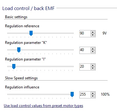

Maybe this will help, here are my settings for the same loco with LS3.0 M4. It's a bit simpler since additional motor CV's were introduced in later loksounds.
voltage is CV53
parameter 'K' is CV54
parameter 'I' is CV55
thanks 2 users liked this useful post by applor
