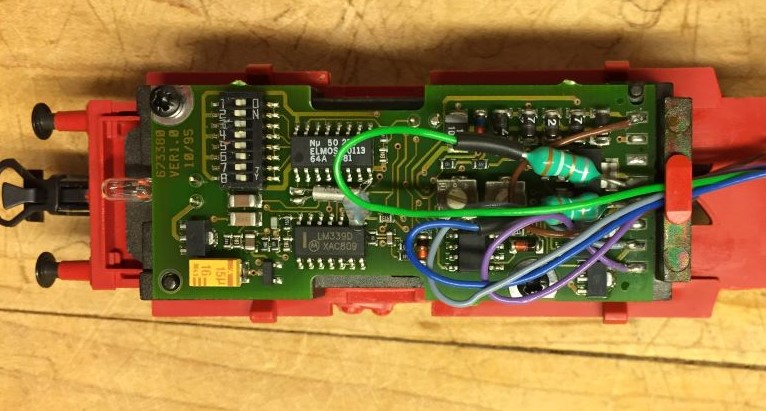

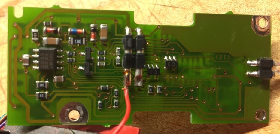

Good evening everyone !! Are you all well ?
I haven't done anything on this loco since I bought it.
This loco has a problem, when I set the direction control to forward it goes backwards with the front light on.
When I set direction to reverse it moves forward with the back light on.
I've taken a couple of pictures of the decoder and the way cables have been soldered, not by me.
I tried swapping the motor cables on the chokes but nothing changes.
The grey cable is attachedcorrectly to the front light.
So where has the cabling gone wrong with this decoder ?
The spare decoder number is: 673380
Thank you
Marco

Looking at your wiring I can see the problem. So wiring from the purple end: Purple - AUX - grey - Green "motor" - Blue"motor" - AUX - Red - Brown.
[img]UserPostedImage[/img]
Image shown here is of the original decoder #37880 (602758 V1.1). Your decoder looks like a later version.

My PCB says 1.0
So it looks like I can have the smoke unit on / off by the way you describe your connections
if I solder the smoke unit contact to one of the AUX points.
I'll rewire it then following your photo
Thank you Dave

Dave, on my PCB, contrary to your picture and explanation I have
OUT OF BOX
purple, grey, empty, green, blue, empty, red, brown
DAVE's PHOTO
purple, EMPTY, grey, green, blue, empty, red, brown.
Swapping the grey cable as per photo switches off the front light completely.
Tried all possible combinations testing with the free grey cable all the available solder pads. Nothing.
So as I have an EcOS, one of the best and powerful systems, I told myself 'this is not possible, I'm doing something wrong. This thing can't win'!!
I put the loco on the programming track and let the EcOS find out which decoder it has.
It came out as Motorola 14 !!!!
I put it back on the tracks and, MIRACLE, everything works properly.
So I've gone back to the Out of the Box cable soldering schema and:
Forward + light works
Reverse + light works.
Lesson to be learned?
An important one, ALWAYS let the EcOS recognise the decoders in the locos :-)
Thank you, your suggestions made me analyse the problem under a different light :-)

Posts: 738
Location: England, Suffolk
If I really wanted to lose a bit more of my eyesight I could go for an ESU LokPilot v 4/5
The 60906 says also the manual is not for locos having a permanent magnet as Dave points out. ESU all the way then, eventually 👍🏻🙂
You all gave me interesting information on these new decoder types
Thank you all
Marco
