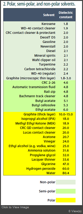

#11 Posted : 08 May 2020 21:28:47(UTC)
Posts: 4,057
Can't recall where I got this list, but someone did the research...
Best at top, worst at bottom:

Location: England, Cambridge
Originally Posted by: Bogenschütze Go to Quoted Post

The way I recall the explanation about the different track cleaning solvents, it was what happened after the cleaning. The polar and semi-polar attracts the dirt, but not the non-polar not so much.
In other words; IPA cleans the tracks OK, but you have to do it again much sooner than if you use non-polar.

Originally Posted by: blid Go to Quoted Post
but I might use WD-40
Note the table in post #11 above specifically says 'WD-40 Contact Cleaner' which is different that the more common WD-40 in the blue and yellow spray can.
Just wondering: when you use IPA, that would evaporate. So there's nothing left on the tracks...

I've never cleaned or lubricated the wheel contact wipers on my loco's, and I am not sure using even fine grit abrasives would be a good idea, but perhaps the OP could try a cleaner/lubricant like I described on those contacts and see what happens.
There's some quite extensive experimentation there and, as usual, some confusing results!
I have to say, I'm reluctant to use anything even vaguely lubricating on my layout as not much of it is on the level and every last bit of traction is valued!
I have been experimenting with WD-40 contact cleaner (which makes a lot of noise about leaving no residue - so I guess we can safely assume is non-lubricating) over the last week, with inconclusive results. I'm not sure how effective I think it is at cleaning track, but I don't think I find it less effective than IPA, on wheels and wheel wipers, I'm not sure. I tried it on my "utility" Ludmilla, which has always been a bit finicky with no amazing immediate improvement. It did, however, start running sluggishly that session, though I think that was mechanical and not related to its earlier cleaning. Where it really did work was on a turnout/point/switch which one of my (four wheel pickup) locomotives was struggling with. I sprayed the section of track with the WD-40 cleaner and that cleared the problem straight away. I was able to do that as that particular point/turnout/switch is in the fiddle yard area of my layout. I wouldn't want to do it in the scenic areas!
I'm optimistic that the WD-40 cleaner will prove itself, I'll keep everyone posted!

Hello everyone. Sorry I'm a bit late to this conversation but thank you Chris for starting it up. I've been modelling in Z scale for over 15 years and in both DC and DCC. I've had the usual issues with locomotives, dirty track, turnouts etc...but the one thing I've noticed regardless for all this time...is that for whenever a layout or track section is left unused for some time...and this could be weeks, months, maybe longer. It often (I'm no engineer or electrician for sure) seems to go "cold." Obviously many responding to this would say...clean the track...CLEAN the track...Clean...lubricant...track eraser.
I mean, yes cleaning does help. Of course it does. But I've always wondered if it was something more than that. You know what I mean? I mean, it's z scale. It isn't that hard or it doesn't take that long to clean the track. Sometime it polished like it's brand new...but it still "takes a while" before the locomotive(s) seem to come back to life on them. I draw (a very bad) analogy to starting up a car engine..or in this case...a sleepy electrical circuit. Yes I know this may sound like pseudo Science..but I've always had it in the back of my mind that "clean tracks" aren't the only reason. Like there was something else to them.
Then up until over the last year or so, I've seen one or two articles and Youtube videos talking not about clean tracks but conductivity. That tracks may not even neat to be dust free..so much as they need to be conductive to the electrons. Now I know this may not be directly related to what you experience, but I just wanted to throw this out there as a fellow z-scaler. And this seemed to make sense to me.
Among some solutions posted are conductive lubricants and even a very fine amount of graphite from a pencil. I have to (quietly) admit, that I have started to try the pencil thing in some areas, and for now - it hasn't made it worse and in some cases, it does seem better. I'll report back when I have something more quantitative than qualitative.
Just curious if others have experimented with this or just had an opinion about things other than clean track.

Thanks very much for your post and comments. As a professional electronics engineer of nearly forty years, I like to think I know a bit about electricity, so I am wary of anything that doesn't seem to have a sound scientific basis! Terms like "conductivity" also have a very specific meaning in physics, so I am also suspicious when they are being used with other, perhaps less specific, meanings!
All that said, my own experience does concur with yours in large measure. As I mentioned in one of the other posts on this thread, my usual regime after a period of non use is; clean the track with a track rubber, clean the track with IPA (solvent currently under review), vacuum the track, run round the Marklin track cleaning wagon several times. Usually after this, things run passably well, but definitely improve more after a period of "proper" running. This also correlates with my experience of exhibition running where it is not unusual to suffer a few "dirty track" incidents within the first hour of running, but where running later in the day is usually flawless.
One thought that occurs to me is that the wheel profile is not flat but conical, so there is little contact between wheel and the top surface of the rail and most of the contact must be on the inner edge of the rail, which receives little of no attention from the track rubber or cleaning cloth. (This does make me wonder if a convex rather than flat track rubber would be more effective.) However, it's plausible that the locomotive and wagon wheels do have a cleaning effect on the rails after a period or running explaining this behaviour.
Another thought is that IPA, I have recently learned, is hydroscopic so draws atmospheric moisture out of the air and onto the track. In addition to this by cooling the track it must cause more moisture to condense on the track. This must be even more profound where you are than it is here in the UK. In any case, it seems again plausible that it will take some time for this condensation to evaporate from the rail surface and that this process is accelerated by running trains.
I have heard some other modellers talk about "wet" running which, I believe, involves cleaning track with a slow to evaporate and conductive fluid (sorry I don't have more details!) and also about the merits of rubbing graphite on your track. I can absolutely see how this would help, but as not much of my layout is on the level I avoid anything that might affect traction!
