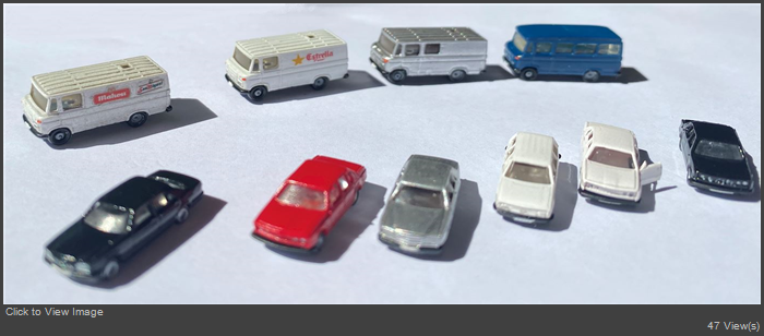

I am a firm advocate of the "view from a distance" philosophy, but I also like to do my best to make my models bear closer examination. Here, for example, are some cars and vans from the Marklin 8903/8904s set I re-sprayed, decorated and "weathered".
[img]IMG_2988.JPG[/img]
The link that Carim posted to the TrafoFuchs website might be of interest to you - they seem to have some early era models, and their shipping charges to the US are very reasonable, too.
Warm regards to everyone!
Chris
Absolutely excellent!
