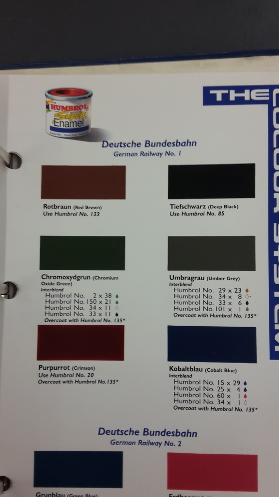

I have some pictures of the Humbrol colour charts for DB paint colours that I photographed at a model shop (with the owner's permission) some years ago. The shop owner has since retired so the shop is now gone.
Anyway, for Purple Red (Purpurrot) the chart says to use Humbrol #20, with an overcoat of Humbrol #135 (which I believe is a satin clear coat varnish).

I asked Märklin for green paint code to my CE800 locomotive.
I'm guessing it is Chromoxydgrun (Chromium Oxide Green). The worst you could do is mix some up and compare it.

Thanks David ThumpUp
I had seen that photo somewhere but didn't find it. Humbrol 195 should be just that RAL6020.
I will try that and mix some up also.

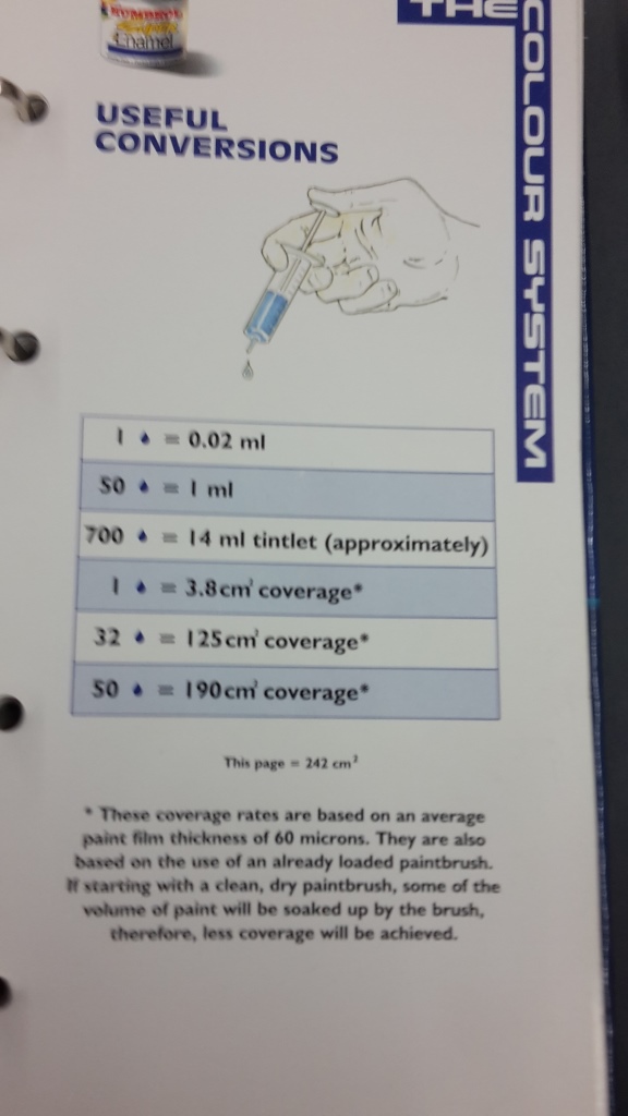

#14 Posted : 20 May 2020 07:35:15(UTC)
Yes I have posted them before, but sometimes it is easier to repost rather than try to find them.
Here's the other two pages.

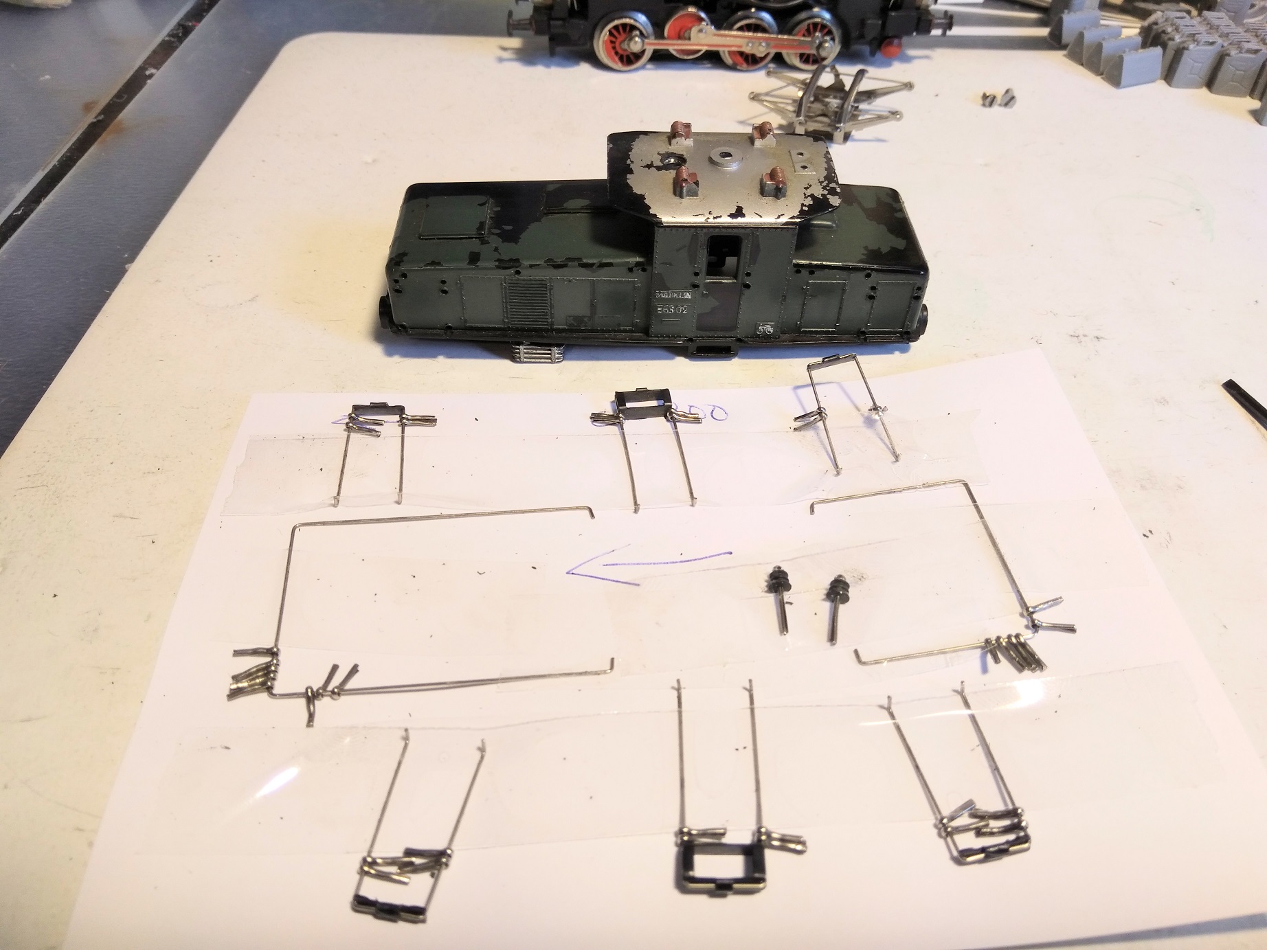

Now I have my old CE800 finally repainted.
Old paint was peeling off and it looked quite sad.
I then dismantled it and carefully stored all loose parts.
I used AK Interactive paint stripper which worked well but it took more than recommended 5 minutes before paint was coming off.
Then I scrubbed the body with coarse sponge and washed it carefully with soap and water.
After it had dried I sprayed two thin layers of plastic primer. After an hour I painted the roof with Humbrol 27001 matt aluminium paint.
Waited 12 hours and painted the lower part with Humbrol 195 dark green satin which was the right shade. Vallejo 71.019 RAL 6007 was too grey.
Finally I sprayed the whole body with Humbrol 135 satin varnish.
Now the loco looks like this.
Many thanks for your advice ThumpUp
